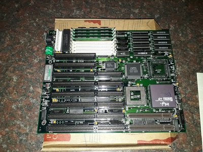

Don't know how I managed to miss this post but, I have the exact same motherboard - the only difference is that my motherboard has the OPTI 495XLC chipset.
However, based on the picture you posted and the BIOS ID string of the BIOS image you uploaded, it's definitely the same motherboard, manufactured by A-trend.
I happen to also have the manual of this motherboard.
While going through my backups, it seems that I also managed to obtain a BIOS dump of this motherboard with an OPTI 495SLC chipset (the BIOS ID string of my BIOS image seems to match the BIOS ID string of yours) - I've uploaded both copies.
If you require a scan of the manual, let me know.

Motherboard
731.16 KiB
416 views
Image of Manual

To be honest, I cannot remember where I obtained the OPTI 495SLC BIOS ROM that I included in my previous post (it's definitely not from a motherboard that I own).
However, I do have another 3/486 OPTI 495XLC motherboard (manufactured by Jetway, the J-402B) where the BIOS became corrupted and through my various searches and posts over the years, I suspect that this is where that OPTI 495SLC BIOS came from.
I did find some of the BIOS images on those Russian sites but, I managed to track down two main sites where I found some old BIOS images for OPTI chipsets:
http://chukaev.ru54.com/bios_en.htm
http://sannata.ru/bios/
The OPTI 495XLC BIOS image that I posted was from the motherboard in the picture

Reply 35 of 35, by UpLateGeek
G'day! I'm super glad I found this thread, since I just picked up one of these boards, and couldn't find any info on it anywhere else!
I haven't managed to check all the jumper settings yet, so I haven't tested it, but I have dumped the BIOS ROM!
http://uplategeek.com/wp-content/uploads/2020 … /opti495xlc.zip
The chipset on my board is the XLC version. I have no idea if that makes a difference, but it was marked AA3535949, and is different from the other ROM images in this thread.
EDIT: I just noticed the XLC ROM, which it is identical to. As AvE says, you don't know till you know and now you know.
