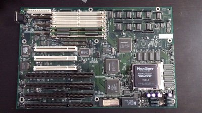

I found this site while searching for information on a NexGen Nx586. I acquired it from my work from an old machine we were scrapping out. I mainly wanted the power supply it was using but decided to look up the mother board too since I had never heard of it.
My question is what is the best way to test it? I still have the power supply but I don't have a graphics card from this era. I don't have a keyboard either that will fit, its the old round connector prior to the PS2, not sure what its called. The installation did not have a display or keyboard, it was mainly powering a few ISA cards that were running stepping motors. No hard drive either just a floppy drive.

Reply 1 of 10, by cj_reha
The keyboard connector is called the AT keyboard port or DIN keyboard port (depending on who you ask), and adapters are super cheap since it is electronically compatible with PS/2. One such adapter is here:
https://www.sfcable.com/6in-ps2-minidin6-fema … TBoCjQsQAvD_BwE
And about the video card, any old PCI video card should work. They can be found cheaply on eBay with some searching, but you can do a much more basic test by hooking up a PC speaker and seeing if it beeps.

Reply 3 of 10, by ODwilly
Some good cards to look for that will work well would be an S3 Trio, Ati Mach64, Matrox Millennium, Matrox G200 or G400, Matrox Mystique, Nvidia Riva 128, Cirrus Logic cards or Tseng Labs cards are also a good pick. Whatever you can find cheap really!
Reply 4 of 10, by ODwilly
Sorry to double post, but just noticed it has a Dallas RTC. That will probably be dead and need either modified with a cr 2032 battery holder or replaced.

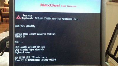

Reply 6 of 10, by Toddm
Looks like ODwilly was correct about the RTC. I'm still trying to source a AT to PS2 adapter or a AT KB.
