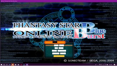

Reply 21 of 33, by todd
1.2 MiB
1899 views
1.31 MiB
1899 views
had to switch to window mode. fullscreen don't work at all on my AMD rig - 4K starts sometimes, locks othertimes, independent of the DPI popup.

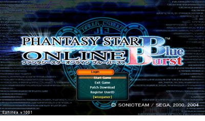

text rendering properly example:
1.04 MiB
1771 views

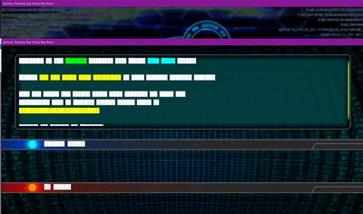

Reply 31 of 33, by todd
MS WARP does not start fullscreen. But text seems fine. See attached graphic with game settings at 4K fullscreen:
792.43 KiB
1776 views
was able to set switchable graphics to Intel chip (power save) and text is fine.
set it back to maximum performance (AMD) and text is gone.
Reply 32 of 33, by GenericHero8
Just wanted to report that an old version of dgvoodoo the text works for me -- specifically 2.54. but lighting is messed up in the lobby. 2.55 does not have the lighting issue, but also does have the block text.
As described previously in this topic, on the newest version currently (2.55.4.1) it does not work on my AMD gpu -- but my laptop with hybrid graphics (intel and nvidia), it does work. Something screwy is afoot
Reply 33 of 33, by GenericHero8
Looks like this is solved by WIP58 -- I didn't try it before because it looked like it might have been the same version as the release due to the same release date -- this was not the case. Thanks Dege!
