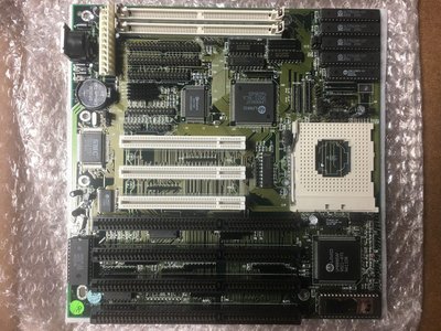

What is the best hardware for this build ?
It's a 486dx-33
The motherboard I am using is generic no-name with PCI slots and only supports 5v CPU and Fast Page Mode ram.
Up to 32mb memory simms. ( 2x32mb ).
Award Bios.
Similar to PM486PU-S3 PCI Motherboard
- BIOS ID string UMC-881/886A - 2A4X5P6CC-00
- 2-72 pin SIMM slots (1-64meg FPM DRAM)
- 3-32bit PCI Bus slots
- 4-16bit ISA slots
- 128k-512k CACHE support in 4-28pin sockets + 1 TAG RAM socket
- Award BIOS
- Supports LBA Mode Control & Large Disk DOS Compatibility.
- Green PC Connector
- external 3.6 battery not included
- UMC UM8881K & UM8886BF // UMC-881/886A chipset
- Supports 3.3/3.45/4.0/5.0 volt CPU's.
- 237pin ZIF CPU socket 2 which supports these processors:
INTEL 80486SX/SX2,80486DX/DX2/DX4,P24T,P24D
CYRIX CX486S(M6),CX486DX/DX2(M7),CX486DX4,CXM1
AMD AM486DX/DX2/DX4
UMC GREEN CPU U5S-SUPER
- Supports speeds of 20/25/33/40/50/66/75/80/100 MHz.
- 32bit Bus master for 2 IDE interfaces supporting 4 IDE devices.
- Multi-I/O chip supports 2 - 16550 Fast UART serial ports
1 - parallel port with EPP & ECP, 1 - floppy disk interface.
- Manufactured by: PROTECH
For CPU I can use:
Intel 486dx-33
Intel 486dx-50
Intel 486dx-66
For Graphics I have:
S3 trio 2mb PCI
Cirruc Logic Laguna 2mb PCI
Matrox PCI
Nvidia PCI
ATI PCI
For Audio I have:
Sound Blaster Vibra 16 ISA
Sound Blaster AWE 64 ISA
Sound Blaster Live 5.1 PCI
Yamaha Audician 32 plus ISA
For ram I can use:
32mb
64mb
128mb
I want to Dual boot DOS/Win98se
Or
I can do DOS/Win3.11
I do not want to overload the computer.
I want best performance for the 486dx-33.
Should I go with Win98se or just Win-3.11 ?

Reply 1 of 29, by BinaryDemon
Some thoughts-
Even with a DX2-66 you would basically be at the minimum requirements for Win98se, I can't imagine that would be enjoyable. Maybe look into a DX4 486 overdrive cpu?
I would rule out 'nvidia pci' unless you do decide to go with win98se since whatever card that is, is likely to be overkill.
I have to imagine that the Sound Blaster Vibra 16 ISA is the most compatible option for dos gaming.
Check out DOSBox Distro:
Reply 2 of 29, by aries-mu
Very well!
So:
• 128 KB of Double Banked cache (ask the forum for details on how to find this)
• CPU 486 DX2-66 MHz (DX 66 not possible, must be DX2)
• Definitely 64 MB FPM RAM (2 SIMM x 32 MB) [I'd be careful going 128 MB, because some DOS games can go nuts], possibly 60 ns (found easily on eBay), of which:
   ○ 1 MB is allocated by DOS and stuff (EMM386, UMB, HMA, etc.)
   ○ 47 MB XMS via HIMEM (or 31 MB XMS + 16 MB EMS if you need EMS too)
   ○ 8 MB had drive cache via SMARTDRV in XMS
   ○ 8 MB Ram Disk via RAMDRIVE, setting TEMP and TMP variables in DOS (and whatever it has in Windows too) to point in the Ram Disk 😉
• 2x IDE-to-CF or IDE-to-SD adapters (in my case, I had lots of compatibility issues with CF cards, while SD cards via IDE-to-SD adapters worked greatly in old 486 and Pentium)
• IDE Primary master: CF or SD card with DOS, Windows 3.11, apps. Be careful with the cards' size due to BIOS limits (having PCI slots my guess is a 4GB limit is safe)
• IDE Primary slave: CF or SD card for data
• IDE Secondary master: Optical unit (As an alternative, you can hook it to the ISA Sound Card if it has any IDE connector)
• IDE Secondary slave: leave it for now, you never know 🤣
• Get a Gotek Floppy Drive emulator via USB memory stick to be "floppyfied" with 100 floppies in a modern computer using appropriate utility (Ask Vogons)
• Video card: go Cirrus Logic Laguna (I guess 5464), very good DOS performances and great compatibility
• Sound card: of course!! Sound Blaster AWE64 😁 (with NO DOUBTS at all forget PCI for a DOS system, go ISA)
• Definitely go purist: DOS/Win3.11 😉 (y)
Enjoy!

So what 486 CPU's are 5v ?
I have a 528mb WD hard-drive. They are in good condition with hardly any use.
runs good and quite for old IDE drive.
I have trouble with getting Cirrus Logic laguna drivers to work under Win3x. I have better success with S3 trio in Win3x.
What about a SB live 5.1 with DOS drivers ?
https://www.philscomputerlab.com/sound-blaster-live.html
Reply 4 of 29, by aries-mu
I'm not sure but my guess is that 486 33, 50, and 66 are all 5 v. Maybe if you Vogons-post a photo of your CPU someone will surely be able to tell you.
Oh believe me... with modern solid state technologies, which make those lovely 486s run smoothly like going nuts, you totally want to use one of those! It's totally worth it, and the adapters are super cheap on eBay, so small cards (below 4 GB).
My 486 on an SD card is so fast Windows 3.11 loads in 4 seconds. Sometimes it didn't even show the intro screen (showing the Windows version).
Ops! I didn't know that.
If you want an advice, try this trick: have a look at a branded-proprietary drivers for Win3.11. For example, the ATI Rage Pro Turbo was a relatively modern card with no drivers for Win 3.11. But some manufacturers actually developed them. I found the Win 3.11 drivers in the Support section for the Deskpro EN in the Compaq/HP support website.
If I recall, certain Compaq models of Deskpro or Prolinea had the latest Cirrus cards. You should go through all the models in their support website:
https://support.hp.com/us-en/products/
Try first searching among the DESKPRO models.
Then PROLINEA models (from the 466 and above, like 590, 5100 etc. I doubt the older versions having the slash in the name carried any Cirrus card, like the 4/33 or the 4/66, except maybe the 4/100 if I recall!).
Select Windows, then Windows 3.x as version, and you should find your drivers showing all the possible SVGA models for the computer model you selected before.
If not, the S3 Trio is very good and powerful. I just don't know about its compatibility with old DOS software. VOGONS guys??? For example, if in a DOS game you select S3 928 or 968, would the driver work in a S3 Trio?
WOOOOOW MAN! Thank you SO MUCH! I didn't know about that!!!

Excellent. I too have bought this motherboard.
It is a reasonable motherboard with one crippling limitation, 5V CPU's only. This will generally limit you to DX2's, and only some of those will work, many of the cheaper ones are low voltage versions.
I intend to go with an Evergreen AMD 5x86 133Mhz. They are reasonably common, but not particularly cheap, on ebay. I already had an evergreen so this board suited me. These have the circuitry to convert 5v to the voltage the cpu needs.
I will start a thread on here about this build. But it isn't my highest priority right now.
