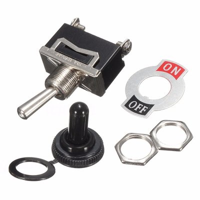

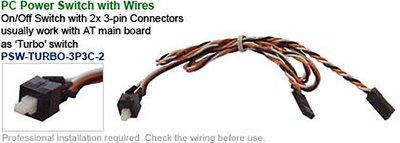

Reply 6 of 7, by Intel486dx33
For turbo switch I took a blank from the back of the computer case drilled a hole and added this switch.
https://www.ebay.com/itm/Heavy-Duty-ON-OFF-Sm … 872.m2749.l2649
wires
https://www.ebay.com/itm/65cm-PC-Computer-Hos … TitleDesc=0%7C0
