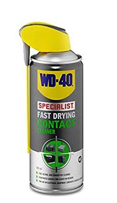

Is the ram removable or soldered on? It could have worked its way loose and just need reseated?
If you're reseating, try cleaning the contacts with some isopropyl alcohol and a lint-free cloth. WD-40 CONTACT CLEANER *emphasises the contact cleaner part of the statement* is also good as it's basically spray IPA but it'll also take off any ink so be careful if there's something written on the board.
