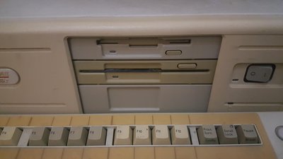

So, for those of you who haven't met, this is Bessie.
239.97 KiB
1782 views

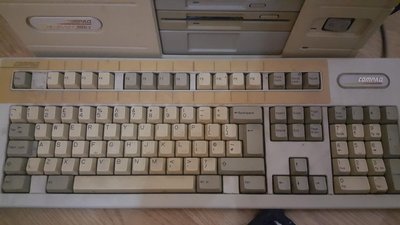

It's got the classic keyboard, which unlike every other keyboard I've ever had since, the spacebar has zero wobble in it. None. It goes down and up again. Marvellous.
296.83 KiB
1782 views
There's the classic floppy drives, with the mandatory, though largely decorative 5.25", and the useful, but in this case non-functional 3.5".

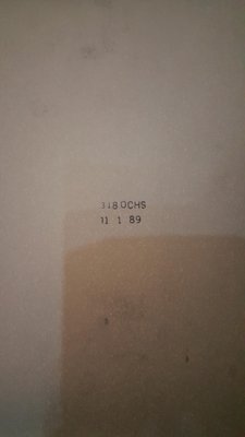

It even has its birthday stamped on the inside. Not sure if it's US or UK format as the only other example of this I'd seen was US format, but the code above was also reversed. Several of my friends who have been following Bessie's saga are younger than it. That's not terrifying at all. 😒

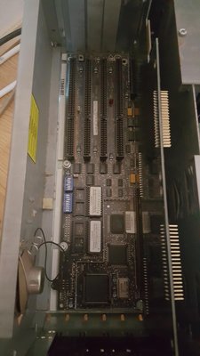

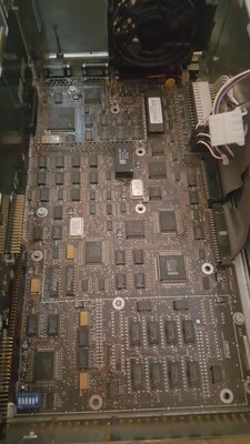

So lets see what we have:
339.6 KiB
1781 views
So we have the BIOS on 2x socketed ICs, the processor is an Intel 16 MHz 80386SX, and I've been lucky and also got the Socket F/ 16MHz Intel 387SX coprocessor so if I ever play the select handful of games that use it, I may notice ever-so-slightly improved gameplay... Of if I feel like doing some CAD on a 386...

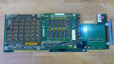

The memory:
497.6 KiB
1776 views

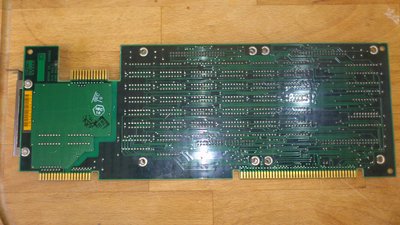

On top of the whopping 1 MB on board, we have this additional board - a Kingston KTC-1000s which supplies an additional 1 MB RAM and if documentation on the internet is anything to go by, it never existed at all. The pins are for additional memory modules (of which I am on the hunt for, the 4 MB modules preferably but I'd still take the 1 MB). One thing I notice compared to other compaqs is the sparse population of this board. All others seem absolutely chock full of ICs, but this one only has a sprinkle. It does the same job though so I shan't get too up in arms about it.

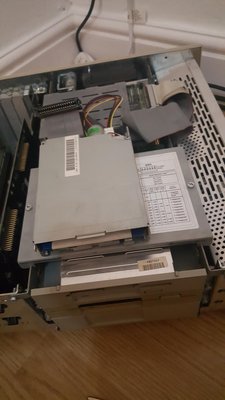

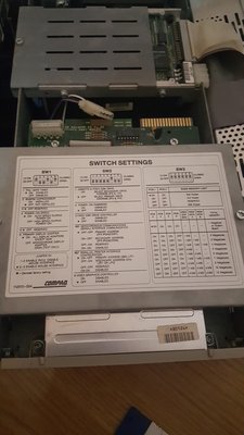

A quick look at the drive-bay cage with bios switch settings. One unusual thing with these bios switches is that the black dot corresponds not to what side the "light" (ie the fluorescent pink strip on the switch) needs to be visible, but to what side you need to press to get the correct setting. Turns out I had SW1 settings backwards for a while, Bessie never booted then either.

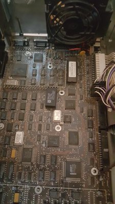

Moving back to the mainboard now, once the cage is removed we see the rest of the gubbins that make it work, along with what is causing me all this headache in the first place. That pesky dead DS1287. Luckily it's socketed so it just pops out. Time to install a shiny new DS12887.
451.18 KiB
1776 views

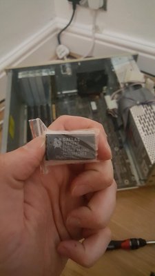

Reply 2 of 13, by Vaudane
Right so with the new DS12887 nestled nice and snug in the motherboard!
484.15 KiB
1773 views

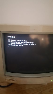

So lets reassemble! As I said, sadly the original floppy drive isn't working, so I had to make do until I can be bothered fitting a new one properly/repairing the old one.
271.78 KiB
1773 views

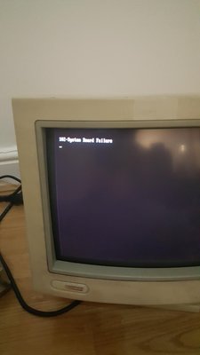

AAAAAAAAAAAAAAND....
173.28 KiB
1773 views
Bugger.

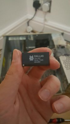

Reply 3 of 13, by Vaudane

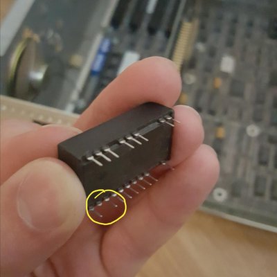

So who would have guessed. The DS12887 has a broken leg.
95.24 KiB
1770 views
After pulling out the remnants of it from socket and making sure there no random little bits of metal left that could short something out, I figure I should make sure I haven't damaged anything. So dropping the original 1287 back in, I don't bother putting any of the original drives back in, I just want to make sure.
171.18 KiB
1770 views
Sure enough, the board is fine, just the DS12887 was borked.

Reply 4 of 13, by Errius
That memory card is interesting. I have one of these in my collection but didn't know what it was for. Mine is by Compaq not Kingston though. Can you post a photograph of the back side of it?
Do these cards only work in the Deskpro 386S?

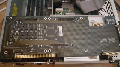

Reply 5 of 13, by Vaudane
Errius wrote:
Can you post a photograph of the back side of it? Do these cards only work in the Deskpro 386S?
I didn't include a photo of the back as there isn't a whole lot to see here. A few traces and the back side of the fingers.
486.32 KiB
1676 views
The compaq is certainly the only computer I'm aware of that they work in, but I think it's a fairly standard ISA memory slot, so there are probably others. I see yours has the memory modules attached. If you're based in EU and are in the mood for selling for not-modern-GPU-cost level prices, I'd definitely be interested.

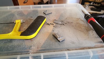

Reply 8 of 13, by Vaudane
So I grew impatient. My DS12885 ICs from China are due to arrive some point... oh... mid October? So I want to see what I can work with just now.

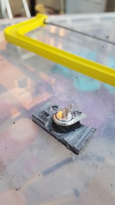

So, investing in a nice shiny new 24 teeth-per-inch junior hacksaw blade, I decide to investigate exactly what's going on inside the DS1287. Having read (I think on the Vogon forums) that the 12887 is basically a 12885 with a crystal, battery, and a cap epoxied on, I decide the top of the cap is coming off. So folding the pins in so I don't break them, I get to work with my new hacksaw.
507.81 KiB
1615 views

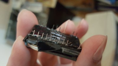

Turns out not only is the cap epoxied on, but the entire void is epoxy filled.
Right.
I know there's a battery in here somewhere though, so after an hour or so of sawing, then cracking bits off with a screwdriver I first uncover the battery, then clear enough space to crack it out.
253.15 KiB
1615 views
Yup. It's just a button cell hiding the sneaky sneaky print on the IC... That says 1285. It's literally a 1285 with a battery and crystal (you can see the case for this poking out the left side of the chip) attached, filled with epoxy, then sold for 5x the price to take advantage of the fact it'll be the only chip to do the job its doing, while fitting that socket. Time to get a tabbed CR2032 from Amazon prime and see what I can do with this and some gaffer tape.

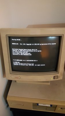

So, the new question now is ... Do I stick with DOS 2.04 from 1984, or do I upgrade it to 6.22?
Reply 11 of 13, by pentiumspeed
Vaudane wrote on 2018-08-03, 18:07:
The memory: 20180803_001444r.jpg On top of the whopping 1 MB on board, we have this additional board - a Kingston KTC-1000s whic […]
The memory:
20180803_001444r.jpg On top of the whopping 1 MB on board, we have this additional board - a Kingston KTC-1000s which supplies an additional 1 MB RAM and if documentation on the internet is anything to go by, it never existed at all. The pins are for additional memory modules (of which I am on the hunt for, the 4 MB modules preferably but I'd still take the 1 MB). One thing I notice compared to other compaqs is the sparse population of this board. All others seem absolutely chock full of ICs, but this one only has a sprinkle. It does the same job though so I shan't get too up in arms about it.
Wanted to comment on your KTC-1000S expansion card. Noticed there are no PAL IC on yours, much easier to reproduce new expansion card clone since not have to decode that PAL programmable logic.
And can take either 1MB or 4MB on same board.
Can you tell me what are these 4 ICs that is around the memory chips?
Cheers,
