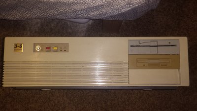

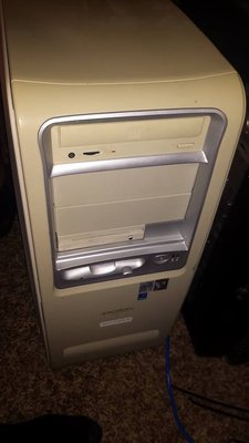

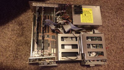

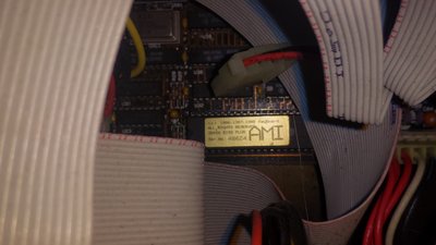

Some pics of the currently non working 386 machine:

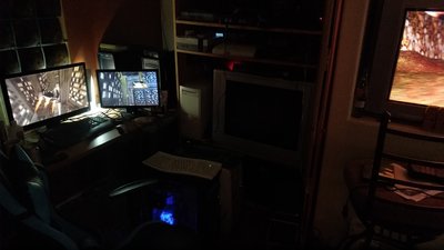

I've got three Slot 1 based Win98SE cloned Maxtor drives running finally. The good ole P3B-F kept the PIII 800e, Matrox Mystique, m3D and Monster 3D Voodoo1 selectable. I swapped out the GeForce 256 and put in the 3D Prophet 4500 Kyro II instead. Benchmark results in Quake 3 Arena, Final Reality, 3dmark99Max, 3dmark 2000 and 3dmark2k1 have been run already with no errors. Results will be collated and posted later, but overall this is very comparable to the GeForce 256 with the added plus of environment bump mapping support.
451.42 KiB
1047 views
Benchmark Slot 1 mayhem
Try as I did, for days, I could not get my new to me Guillemot Maxi Gamer Phoenix 16MB 3DFx Banshee AGP card to play with my original Asus P2B board. With the same cloned install of 98SE as the P3B-F system I could install a TNT 2 Ultra or the Geforce256, but this Banshee would freeze whenever I attempted to install drivers for it, or access the hard drive in My Computer or Explorer. This, of course, was after clearing all motherboard and video card drivers in safe mode and letting everything reinstall. So, the P2B gets to have a PII 400 and the GeForce 256 instead. So far I am shocked at how CPU dependant the 256 actually is. On the PII 400 its performance drops well below the Kyro II it formerly trounced in some areas with a PIII 500 system. As it is, a PII 400 Mhz and GeForce 256 would represent quite the out of reach financial burdon to my college spending budget back in 1999, so this will be the redubbed 99Box. Technically the PIII 800e and Geforce 256 represent the peak of 1999's PC hardware performance, but pragmatism wins then and it wins now.

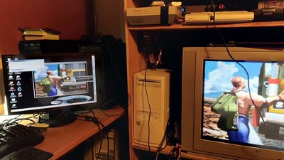

Newest Addition, PIII 500
Finally, another one of my recent acquired PCs happened to be an Athlon XP 2600+ with a Radeon 7500 already installed, a simple Windows XP cleanup job and swap with my All in Wonder 7500 restored to me the single best video capture solution I have ever tested for S-Video or Composite signals.
