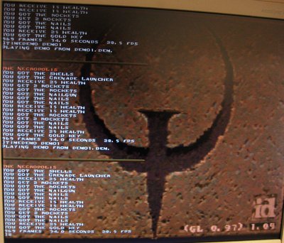

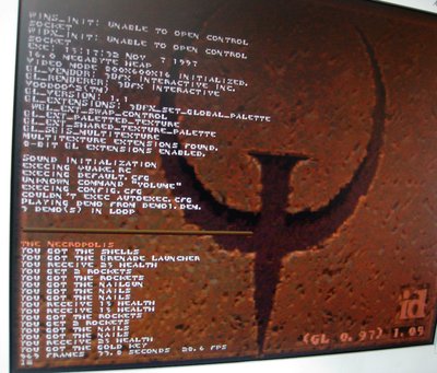

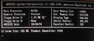

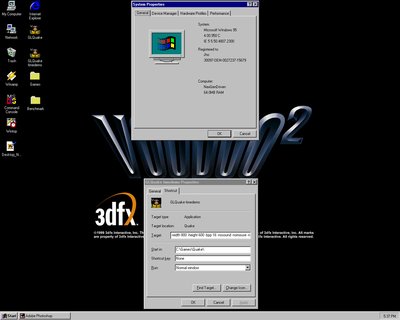

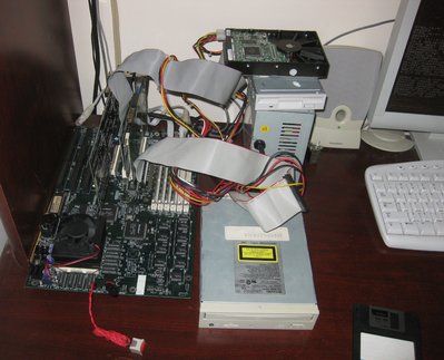

Here is a little bit of a teaser for the ultimate "486" benchmark version 2.
NexGen Nx586 PF110 running GLQuake in Windows 95c. Notice how the GLQuake results are the same as the IBM 5x86c-133 (28.5 fps)? It is only running at 102 MHz, though I somehow was hoping for better results. There are two screen shots because one is at 640x480, the other at 800x600. Results were the same, minus 0.1 fps.
I may also have my hands on the venerable Am5x86 which runs at 200 MHz for version 2 of the ultimate comparison.
