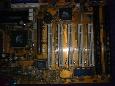

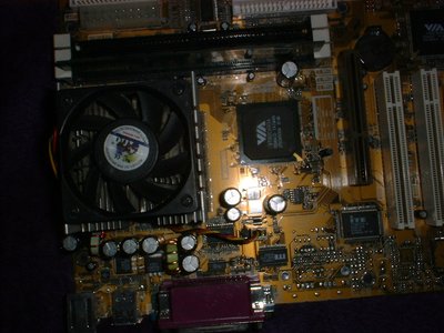

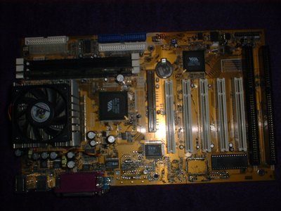

So I aquired this motherboard recently ..but a manufacturer I've never heard of ..
and had difficulty even identifying it ..
It appears to be made by DIGIMATE ..and the IDENT DM-12390-1
at first look it appears to be quite 'useful' though drivers may be hard to find ..
I dont even know it's relative age ..thus not really sure what OS was it's intended target.
It has 2 x ISA slots One of which is shared ..either/OR PCI
so 5 pci and 1 ISA or 4 PCI and 2 ISA
It also has an AGP 2x slot
3 x PC133 ram slots ..
2x Serial and 1 Parallel ports
2 onboard USB
PS2 mouse and Keyboard
Chipset ..
I can list the chip numbers ..but from what bit I read is VIA Apollo.
VIA VT82C596B
VIA VT82C993A
ITE
IT8671F-A
IT8687R
2x IDE connectors
1x FDD connector
ATX Power
Digimate BIOS CHIP
No onboard Audio or VGA
Socket 370
will take Pentium III and I suspect a Celeron ?

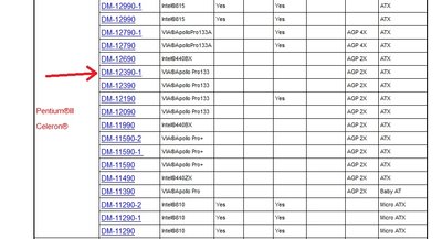

I'm attaching a couple of photos ..plus the only bit of documentation I found .Mine is indicated by a red arrow.
Chinese manufacture possibly ??
So ..what have I got here exactly ??????
More mystery meat ?
Any comments or additional info would be VERY much appreciated ..

The ITE IT8671F-A looks like the I/O chip, and the ITE IT8687R is the buffer chip.
The VIA VT82C596B (Apollo Pro133A) is the main chipset/northbridge and the VIA VT82C993A is the southbridge.
Drivers can be found on PhilsComputerLab's website: https://www.philscomputerlab.com/via-chipset-drivers.html (first driver at the top). I've never heard of that brand before either, it looks like it supports Windows 98SE up to Windows XP, and I believe that board supports up to a 933MHz Pentium III at 1.75V and 256KB L2 cache. If you want to use an ISA card that uses -5VDC, I suggest an ATX to ATX with the -5VDC for better support. I also have a board that's close to that as well (Shuttle AV18V31), but with an AMR slot (audio modem riser).
Nope. That "VT82C993A" is almost certainly a typo, it should be "VT82C693A". Which is the ApolloPro133 (non-A) northbridge. The 596B is an early 1999 southbridge, offering ATA-66, and was the last one without integrated Super-IO, hence the ITE chip.
The AGP 2x is another indicator that this is an ApolloPro133 and not a 133A (as that has AGP4x) - and of course the "documentation" in the OP. Altogether this looks like a very early and/or low-end ApolloPro133 board.
Yep, this is standard Via 4-in-1 territory. If for some reason Phil's version gives you problems, there are several more on Vogonsdrivers.com you could try, or indeed just download them from Via themselves - they still have old Win98 and XP drivers.
The socket is an So370 FC-PGA socket, so electrically it will take any FC-PGA P3 or Celeron, any PPGA Celeron, and any Via C3. As for what the BIOS will support... that's another matter entirely. The thing to watch is the CPU stepping, which is more relevant than its clock speed.
As for AGP... if you're doing DOS, you'll want something that plays nice there. Probably an early nVidia card would be best; you can get TNT2-M64 and Gf2MX cards pretty much for free and they would suit this just fine. Remember that AGP 4x cards are backwards compatible with AGP 2x (but AGP 8x cards are NOT). If you really want to limit yourself to an AGP 2x card, you're castrating your more modern OSs, but you could try a Riva128 or even an S3 Virge.

According to the web Archive from 2001
https://web.archive.org/web/20010306145938fw_ … /dm-12390-1.htm
this may be the generic manual for the board
http://support.pcpartner.com/support/man/intel/c93100bv.pdf
and this may be a compatible bios (based on searching this page for the part layout / model code from the manual 35-c931)
http://support.pcpartner.com/support/bios/VIA694.HTM#pro133

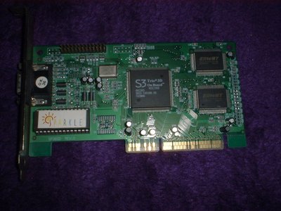

I've hit a roadblock already ..as far as graphics goes ..
I literally have only one card which will physically fit in the AGP 2x
a Sparkle S3 Trio 3D
Doesnt look much and I'm doubting it's ability to get the job done.
I guess it's back to flea bay for something a bit more Hi end ..
suggestions welcomed.
