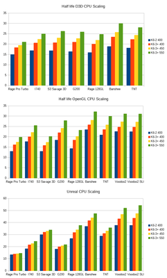

I finally got the K6-3+ and I tested all the cards in the Asus board with the K6-3+ at 550MHz. The rest of the setup was the same, although I did need to update the BIOS to support the K6-3+. The BIOS update actually made most of the cards much more stable except for the Rage 128. I didn't get a single lock-up or crash on the other cards with this BIOS. With the Rage 128 it would lock-up every few minutes, it was so bad I thought maybe I broke the card. So I ended up testing it in another system (440BX P2) and it worked fine. I didn't notice much change in performance with the new BIOS, just the savage got a bit slower in some D3D games.
Anyways, here are the results:

Rage128 scaling is about as good as I thought if not better and Banshee continues to impress! Banshee in particular has replaced Voodoo 2 as my goto P2 video card.
Lucky you on that K6-3+ grap I still xant get a K6-2+ for cheap.
Oh one question for you: when doing all these card swaps do you image and restore Win98 at every change or can you just uninstall the card from system and the deivers from Add/Remove Programs and be clean enough? Always wondered..

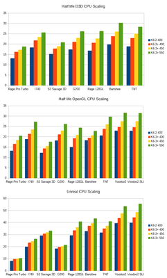

Ok, I also retested the cards in the luckystar board (via chipset) with the K6-3+. I used the same setup again. Just with an updated BIOS. With this board the Savage3D was unstable. I got a few lock-ups running the benchmarks. The G200 has a few quirks on this board and the BIOS didn't fix that. With the G200 this board would lock-up loading windows on a warm boot and sometimes windows would hang shutting down. All the other cards worked fine on this board now, even the Rage 128.
Here are the results:

Yeah, Rage 128 is a great card with MMX instructions and fast CPUs but a dog on AMD 3DNow CPUs.
Also, that Banshee, WOW again. I have newfound respect for the Voodoo Banshee thanks to this thread. Voodoo 2 has next to nothing on the Banshee in real testing.

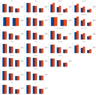

I also tested the G200 with SGRAM. Here is a comparison with the SDRAM version of the card. The SGRAM version is the one used in the OP.

I think it's actually surprising that the Banshee is behind a single v2 in almost every benchmark? The Banshee is a higher clocked version of the Voodoo2, but with it's own 2D and without the second texturing unit. It should only be slower in multi texturing games, and on others it should be faster. So I don't really get what made you so excited?
But I still agree that the Banshee needs to get more love: It's a good retro card. But it can still be found cheap so that's a good thing 😎

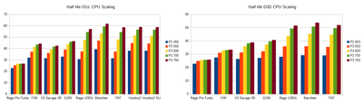

Yes. Performance improves in half life on the TNT and Voodoo2 sli even going from a 1GHz P3 to 1.4GHz. Even the G200 gains performance in half life going from a 750MHz P3 to 1GHz.

Just another update. I found some older drivers for the Rage128GL that are much faster. I updated the OP with the new results and I updated my post with the P3 750MHz results.
Also, here are the CPU benchmarks for half life:

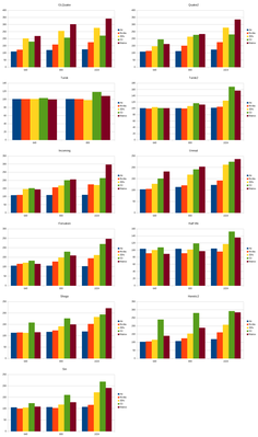

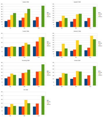

Ok, so I decided to test these same games on some of the 1999 cards and compare them to the 1998 cards of the same brand. I tested them all in the same system; the P2 450 with 128MB of PC100 CL2, the aopen mobo and SBlive sound card.
I thought it would be interesting to see what kind of gain you would get from just upgrading a 1998 system with a new video card from 1999.
For the 1998 cards I used the Nvidia TNT, Matrox G200, Rage 128GL, 3Dfx banshee and S3 savage 3D. For the 1999 cards I used an nvidia TNT2 pro (143/166), Rage 128 pro (125/143), S3 Savage4 extreme (160/166), Matrox G400max (150/200) and 3Dfx voodoo3 3500TV. I tried to use the same driver version for each, that didn't work out for the Savage comparison just because I couldn't find many different drivers for those cards. Also, my Rage128 pro is not made by ATi so I could not get all the same drivers to install on that card. Many would install with an INF edit or just installing the driver manually but that did not work with many earlier drivers. I'm also thinking about testing the TNT2 ultra, I didn't have one when I started testing. I might also add a comparison to the Geforce 256.
Anyways, here are the charts:

And for 32Bit colour:
