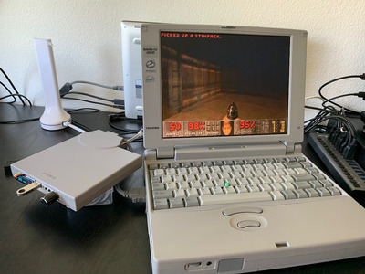

Toshiba Satellite Pro 430CDT

Anyway, under Win95 I can run games at 800x600, yes (e.g. Seven Kingdoms). I have not tried 3D games at that resolution (would run extremely slowly anyway).

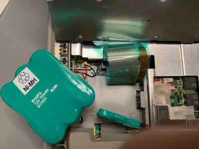

My 430CDT came with discharged but otherwise working Li-Ion (laptop still can work for around 40-60min!) and two completely dead zero-volt Ni-MH batteries, but no leak onto electronics. I removed both NiHM batteries as recommended. I put Li-Ion half-charged aside, as I don't trust 25 year old batteries 😉 I only replaced the BIOS battery with similar specs 20mAh 3.6V NiMH. I bought for around 10 dollars. I simply swapped the plastic plug enclosures. I think there are some sites selling "original" Toshiba batteries, but I don't see point of paying 40 dollars for such thing.
231.44 KiB
1305 views

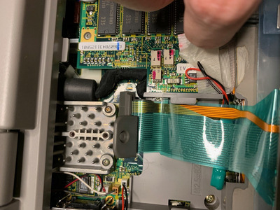

The BIOS battery cable was caught in some adhesive tape under metal bracket, so I had to remove this first to free the cable.

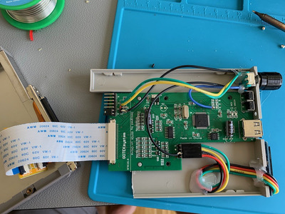

Now I want to write a bit more about GoTek/Flashfloppy fitting into Toshiba enclosure. This took some effort but it was fun and it was worth it! Despite the whole procedure was only partially documented in "FF with 26-pin header Gotek Floppy" project issue and some other Flashfloppy wiki entries, I managed to successfully mod SFRM72-DU26 720K (much cheaper than 1.44MB model that only differs in firmware) I got for around 23 dollars. I fitted small OLED display and additional rotary encoder I had lying around. With 1mm FFC PFC extension board I managed to connect everything without straining Toshiba enclosure flat cable.

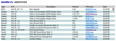

I think some of the files that were on the support.dynabook.com site have started falling off. The internet archive has lots and I put together a personal archive with working links that I should really put online at some point. Here's the list of files for the 430 laptops, you might be able to find them by searching for the filenames:
Yeah, the proper type of RTC batteries are going to have the same problem. I've had recently bought 3.6v nimh battery packs leaking just in storage before they've ever been used, it's likely many of these are old stock and will fail just like the original cells did and on a similar timeline. One thing that might help to avoid future problems is to use solid core wire at some point, it seems like electrolyte can wick through multi-strand wires over time.
If reusing the original plug wires, give them a bath in some vinegar or lemon juice and wash them to make sure there's nothing corrosive left in the cable that could do damage.
Personally I think that two diodes and a CR2032 or two are the way to go but I haven't tried that on my Satellite 400 to 430 laptops yet.
Now I want to write a bit more about GoTek/Flashfloppy fitting into Toshiba enclosure. This took some effort but it was fun and […]

Wow that Toshiba caddied flashfloppy looks superb. I've got that same SFRM72-DU26 but it's not mounted in anything, I might try it in an external caddy - I really like your idea of using a 26pin 1mm flex cable extender to get around the different connector/cable positions inside the caddy 😀
The caddy you've got is from a Tecra (500 to 750 models) or later satellite laptops (440 to 490) which has the right connector. Sometimes those have direct drive floppy drives in them or you can use the direct drive floppy from a darker grey tecra 8000 series in its place. Good to know that a regular flashfloppy can work with no special requirements with Toshiba laptops, thank you for sharing your findings with this.
