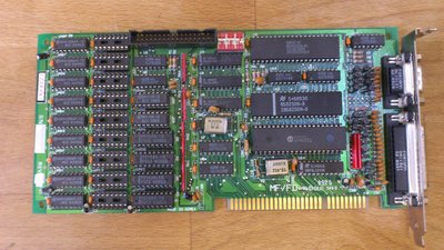

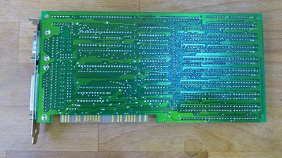

Hi all, can anybody identify the attached card? I am particularly interested in knowing the DIP switch settings.
General description:
Markings: MF/FD / DH-01.94V-0 / 8925 / Rev. E/B.
"8925" is probably a date code. MF/FD presumably stands for multifunction floppy drive.
6-switch DIP switch block at SW1.
Card provides RAM expansion, floppy controller, serial port and parallel port.
It has 4x DIP-18 and 11x DIP-16 sockets. There are also 9 of the following soldered to the board: Samsung KM41256AP-12 DIP-16 32 KiB 100 ns DRAM (This is 41256-class memory). 4 of 4 DIP-18 and 2 of 11 DIP-16 sockets are populated. The following memory chips are present:
  • 4x Intel P21464-10 DIP-18 32 KiB 100 ns DRAM
  • 2x Samsung KM4164B-10 DIP-16 8 KiB 100 ns DRAM (This is 4164-class memory)

I couldn't find the card by scanning visually the pictures in TH99.
The chips on the card provide a total of 384kB RAM (9x41256=256kB plus parity, 4x21464+2x4164=2x64kB plus parity), the larger chips are from top down: FDD controller, serial controller, printer/parallel controller. Cannot say anything about the DIPs. It's similar to a few memory/IO cards made by Kouwell but doesn't match any of them.
Based on my experience with similar cards, it's probably meant for PC or XT to backfill main memory on machines with less than 640kB RAM, and provide IO and floppy ports. I have a card with similar functions, a Diamond Flower MF-100 https://stason.org/TULARC/pc/io-cards/C-D/DIA … 0-MF-100-A.html the manual for which was uploaded to http://minuszerodegrees.net/manuals.htm#DFI It has jumper settings for that card, and while they won't match the DIP settings on yours it may give you an idea about what to expect. Mine came with a floppy with utilities (ramdisk utility, print spooler etc).

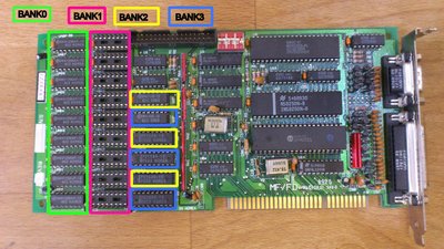

ETA: From what I can determine, there are four memory banks, two of 256 KiB and two of 64 KiB, for a total of 640 KiB
  • Bank 0: 8+1P DIP-16 soldered to board (256 KiB + 32 KiB parity)
  • Bank 1: 8+1P DIP-16 socketed (256 KiB + 32 KiB parity)
  • Bank 2: 2 DIP-18 + 1P DIP-16 socketed (64 KiB + 8 KiB parity)
  • Bank 3: 2 DIP-18 + 1P DIP-16 socketed (64 KiB + 8 KiB parity)
It is currently configured for 384 KiB as mentioned above, as Bank 1 is unpopulated
I assume that the 6 DIP switches enable/disable (a) the floppy controller, (b) the serial port, (c) the parallel port, (d) memory bank 1, (e) memory bank 2 and (f) memory bank 3. Switch 6 is in the "off" position and all others are "on", so I assume that this is the Bank 1 switch. Absent documentation, everything else will have to be determined by experiment.
