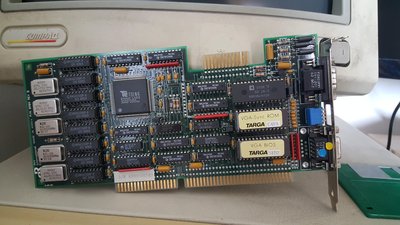

Anyone ever heard of this card before? What's the difference between this and the ET4000AX?
Ediit: Here's a picture. In addition to the VGA port it has a 9-pin dsub and a stack of Xtals on the left. What is this thing?

Strange card.... Looks like a card with outputs for both vga and ega monitors.
There are a lot of crystals on it too. Wich makes me think of an ET-3000.
Never seen or even heard about the 4000-C chip before. New to me.
Reply 2 of 14, by fitzpatr
This chip has an earlier date code (9002) than any ET4000AX that I can find. Prototype perhaps?
The earliest ET4000AX that I can find is in this thread, with a 9008 date code.

Yeah it seems like a hybrid between the 3000 and the 4000AX, I've seen a couple of 3000s with the array of Xtals on the side and the Ega port (I assume that's what it is). Most also lack the CE connector at the top too which ive no idea what would be used for. Primitive sli???
Reply 5 of 14, by root42
Feature connector. Used for direct memory access, e.g. for video playback cards and the like.

Uhmmm... It has a feature connector. Looks like a connector on a 5,25 inch floppy drive.
Reply 7 of 14, by Vaudane
This thing is getting stranger and stranger. An unknown, possibly prototype board, has dual output, (possible) video capture or something else using the feature connector (thank you for that peeps - Every day is a school day), and resembles the evolution between the ET3000 and the ET4000AX. The *missing link* 🤣

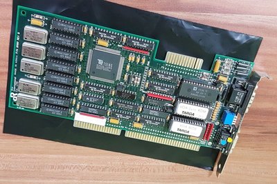

So it finally arrived from Germany (with a small amount of sand in the static-dissipative bag... wtf?) and I've mananged to get a good look at it. It definitely looks like some earlier ET3000AX models with the 5 crystals mounted to it. From a .txt document uploaded as a webpage detailing the switch orientation for a ET3000AX it appears I need to have all 4 switches to the "off" position to enable VGA mode, which leaves the 3 jumpers across the board. I've seen some details about IRQ channels and enabling/disabling the EGA port from other SVGA cards so I'm hoping they're in the correct position.

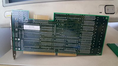

There's also some damage to one of the tracks near the VGA port. I hope it's just topical.

So for the install, I've no idea if I need the 3000AX or the 4000AX drivers (or who knows... a custom driver maybe?). I'll experiment with them both to see what one seems better.
