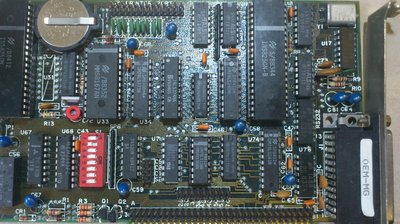

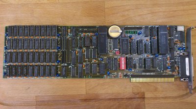

Hi all, can any of you identify this card? It has the following text printed on the PCB: ASY-002008-01 REV A0
It provides a DB-25 serial port on the I/O bracket. There is also support for a parallel port (J2) on an additional I/O bracket, but this is missing.
There is a 34-pin (2x17) header (J5) which may be a floppy drive connector.
There are two 26-pin (2x13) headers which are labelled DTE (J3) and DCE (J4). This may be something to do with telecommunications.
There is an 18-pin (2x9) header which has unknown function.
There is a 62-pin (2x31) header which has unknown function, but which appears to extend the ISA bus.
There is a 3V CR2025 button battery which is probably for a RTC.
The card provides 256 KiB RAM when all 36 (4 x 8+1 parity) memory banks are populated. It uses 4164-class 64 Kibit DIP-16 DRAM memory modules. The following memory chips are installed:
  • NEC D4164C-3 (150 ns)
  • Fujitsu MB8264A-10 (100 ns)
  • National Semiconductor NMC3764N-15 (150 ns)

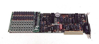

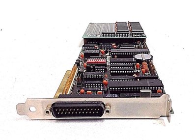

Do you know what the daughter board that connected to J5 might be for. Extra memory?
ETA: added pics of original AST card with 128 KiB daughter board

yep. instead of 256k, the 2nd board will let you have 512k.
I'm usually not a pessimistic person, but experience has taught me it is more likely to have a snowball in hell than find the upgrade card somewhere. If you do, it will come with the base card anyway.
If you had the skill/time/inclination, I don't see it impossible to make your own card. Easy through-hole stuff and all. I'd say it would be faster/cheaper/easier to just find a 2nd memory card.
