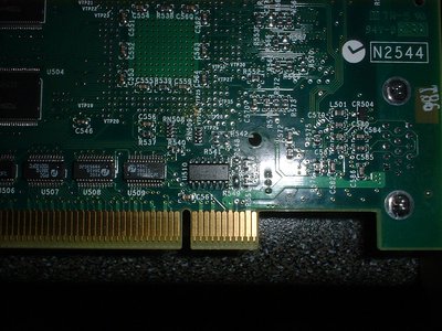

Reply 28 of 38, by Vipersan
...Early Days yet ..
BUT ..looking promising ..in that the Voodoo 5500 PCI now posts ..
see pics.
The replacement glue logic chip arrived and was fitted..but not found any suitable zero ohm restors ..so just added a blob of solder as a link..
but ..to get this far gives me a warm glow..
not counting any chickens yet though..
rgds
VS

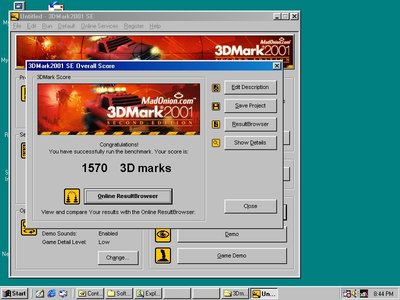

Reply 31 of 38, by Vipersan
Pretty sweet ...
All appears to be working
3Dmark 5704 13034
But only 512mb ram installed atm ..and no sound card ..
Just a bare bones 98se build to make sure the voodoo was working.
Looks like I have a winner.
Reply 34 of 38, by Vipersan
Just for completeness ..I figured I'd upload a photo of the repaired area..
    325.5 KiB
    624 views
Reply 35 of 38, by canthearu
Using a solder bridge as a link isn't a problem really.
The main reason for using 0 ohm resistors is simply because they can be placed automatically by machine during assembly.

Reply 37 of 38, by Vipersan
Here is the result of the Voodoo 5500 pci in the system which will hopefully become my main retro gaming PC ..
The hope is to run both 98se and XP on pull out tray/caddy drives.
But of course I had to try 3Dmark 2001se ..
Of course not all tests can be completed or are indeed hardware catered for.
That said ..I am suitably impressed with what it _can_ do.
No Idea how the result benchmarks with similar systems..but I figure it has to be pretty good ..on account it looked good to me during the tests .
This is the system as is currently and the detailed result.of BlooDoo ....(yep thats what I've called the build 🤣 ...on account the tower is Blue)

Reply 38 of 38, by Vipersan
Well I just had to know ..
The heatsink I ordered for the Radeon9800se arrived ..and was fitted.
Another OS built on a seperate HD (98se)
and the Voodoo5500 replaced with the Radeon9800se (AGP)
So basically the same hardware ..
3Dmark2001 run up and the card tested..
This time (obviously) there were no hardware missing passes ..and the test completed smoothly.
3Dmark was 5350
I guess the choice for gaming is obvious ..though I think the Voodoo would produce wonderful results for period correct games.
I wonder if you can fit both ...🤣..
I'll probably just build another PC for earlier games which uses the Voodoo to its full potential.
It does make you wish 3DFX hadn't been bought out and dumped..
sadly ..that's life..
I have 2 wonderful cards..but each belonged to a time slot now gone.
cest la vie.
