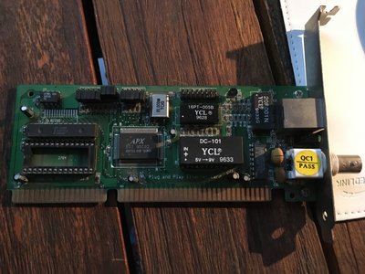

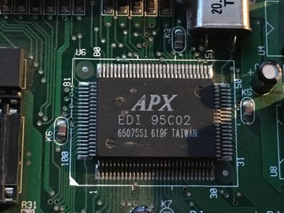

I plan to get my 286 into my LAN (not internet...). I have this NIC, which might be fine. But I will need a packet driver for it. Does someone know this NIC? I tried google but hit mainly Linux infos.
Target is Windows 286 standard mode. Since WfW 3.11 won't run on the 286.

Hm, I found matze79's german tutorial on getting a 286 with tcp/ip into a network (http://www.dosforum.de/viewtopic.php?t=9981), and I wonder if my card is NE2000 compatible. That would make things easy. I could also use the Boot ROM socket for my XT IDE BIOS. Would save a slot...

Reply 3 of 9, by chinny22
If generic ne2000 compatabel drivers dont work you can try putting it in a Win9x or 2000 PC and see what it detects it as
Reply 4 of 9, by dionb
This thing will almost certainly support PIO-based NE2000, most likely also the faster WD83xxx shared-memory design. So drivers are relatively trivial.
Much bigger challenge: those jumpers. Unless the settings are documented on the back, you need to find documentation elsewhere.
When I get home today I need to hunt for one for another card. I'll keep an eye out for this card too.
Reply 5 of 9, by akula65
The card appears to be a LONGSHINE Technologie GmbH LCS-8634PTB:
http://manual.longshine.de/3_Network_Driver/1 … rk/LCS-8634PTB/
The back of the card should have an explanation of the jumper settings:
http://labmaster.mi.infn.it/a2/a2540.html#almlanchor14516
Reply 6 of 9, by stamasd
That card looks like a good candidate to be used with ROM chips as well as you can set the address of the ROM at many addresses with jumpers. Not many cards have that option.

Reply 7 of 9, by root42
Yes, back has the jumper settings. So I will be fine I think. 😀
Thanks for the infos to all of you!
