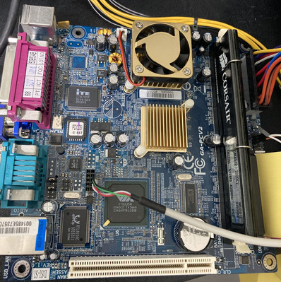

Through some sort of miracle, I've come into ownership of three Gigabyte GA-PCV2 motherboards. it seems these were manufactured by Gigabyte for VIA/iDOT in the mid-'00s, and have a C3 Nehemiah 1GHz re-badged as a "pc1500" chip, and aside from having an unlocked multiplier (the BIOS allows for the setting of up to 133x16, 2.13GHz!!!), the boards are no different than your usual VIA C3 offering. CLE266 NB with integrated S3 Unichrome (non-Pro) IGP, VT8235M southbridge, RTL8100C 10/100, Realtek AC'97 audio codec chipset, single DDR slot, 2x PATA, 2x USB ports and 2x USB2 headers, 1x serial port and 2x serial headers (or so it seems?), 1x Parallel, and a single PCI slot for expansion of any kind.
There's not a lot of information out there about this board or its other few like-model counterparts.
VIA announced these as part of the pc-1 Initiative: https://en.wikipedia.org/wiki/VIA_pc-1_Initiative and, it very well seems VIA sold this through iDOT when that was a thing too, and the manual, original OEM drivers (which isn't a big deal, easy enough) and latest BIOS update (THIS is a big deal... headaches!) were never archived properly on the web archive and have since fallen off the face of the planet. The only thing that sets my boards apart from others I've seen on the internet is that mine have their S-Video and Composite output jacks populated and working.
In my testing, XP SP3 (and WinFLP SP3, which I had install media laying around for) runs A-OK. Debian Stretch runs okay as well, and OpenBSD refuses to boot. booting from USB is tricky unless you dd the ISO file directly to the flash drive. Otherwise, the board will not boot it correctly in some cases for non-windows ISOs. Transfer speed during USB boot is limited to USB 1.1. Plans to test Win2k and 98SE installation and performance are underway as time allows. I've already overclocked one of them to 1.3GHz with fresh compound and was messing around with UT99 and Quake III on it. it doesn't do either half-bad, but the onboard graphics are very lacking in that it limits the screen resolution to 1280x1024 maximum. Definitely needs a better PCI video card of some manner, like a Radeon 9250SE, which would be absolute overkill, I think.
Some pics:
