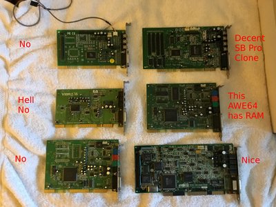

Intel486dx33 wrote:
These are the Sound Cards I have.
Which ones should I use ?
Some also have a Yamaha OPL chip.
That's quite a selection 😀 I recommend the Opti 929 card, it has extra IDE, which could be quite useful, and like you say it has a real OPL3 chip on it. In my experience, it's pretty easy to get working in DOS, does not work so well in Windows 98 but I think is a bit more compatible with Windows 3.11 and Windows 95.
That card that looks like an AWE64 with no ROM, I think that was supposedly a SoundBlaster 16/32 card, it doesn't have any wavetable functionality.
Of the controller cards, probably the green one with the Winbond chips, they should all be fairly similar in performance / compatibility. I recall someone praising the Goldstar card as well.

Do not take the Adaptec card, it's a non-busmaster SCSI adapter except you have SCSI drives.
The Promise EIDEmax seems to have a BIOS that may support IDE discs greater than 2 GB. But it does not have any floppy or RS-232 connector. Perhaps you can use one of your other controller cards with disabled IDE port.
1.83 MiB
794 views
What you choose to go with depends on what you want to do. An AWE64, for instance, is more at home as a Windows card due to the non MPU-401 interface of the EMU chip requiring software emulation. The PAS 16 is a nice card and has onboard SCSI but there's less software with direct support.
Reply 25 of 36, by Intel486dx33
Yes, I did not realize the ISA controller cards only have one IDE connector.
I will have to use another card with IDE connector for the CDROM.
I can use two audio cards.
If I use the AWE64 as my primary can I use the Yamaha OPL MIDI driver from the other card in my MIDI devices setting ?
Going to be running DOS and Win3x.
Reply 26 of 36, by dondiego
Of course not, you can hook up to two devices to a single ide port.
About the sound card forget about that. I'd just use the "decent sb pro clone".

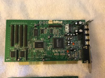

Reply 30 of 36, by Intel486dx33
What driver will work with this card ?
I think it is a Sound Blaster clone ?
P/N: PCB SP16&2#31
Some said it is a "Monte Carlo (Turtle Beach) " ?
Reply 33 of 36, by stamasd
There are some drivers at http://files.mpoli.fi/hardware/SOUND/TURT/
I haven't tested any of them as I don't have any Turtle Beach cards.
Also don't think that the ATAPI/IDE on some sound cards will be useful for a HDD, especially not one that you expect to boot from. You still need a separate controller for those.

Reply 34 of 36, by Intel486dx33
No, The IDE controller is for a CDROM drive.
Thanks for the link.
