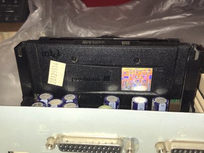

I was looking for a Pentium II 450, and a fellow member of a facebook group offered me one.
I purchased it, and I received it today. However, when I look at the case the lettering says: pentium III... 😲
I asked the seller about it, and he says he tested it before sending to make sure, and it boots up as a PII as yu can see in the attachments.
Does anyone know what’s going on/how this could be..?

Try running CPU-Z or another such utility. The casing on the CPU may have been exchanged or the BIOS might be misdetecting, but the CPUID as detected by software should be reliable.

Why? A P3-450 will work at least as well as a P2-450 in absolutely everything. Only difference is the SSE1 instructions, which are an improvement (if almost never used by period software). I have both and the only difference I notice is the cooler (the P2 has a huge passive heatsink, the P3 a noisy little fan).

The most recent BIOS update for the RC440BX board is from 2000: https://downloadcenter.intel.com/download/914 … -?product=50524
There's a chance you could update the BIOS to recognize the PIII before returning it.

You could try this:
For Intel® Processor Frequency ID Utility
Intel® Processor Frequency ID Utility Bootable version [BFID_X25.EXE]
Version: 7.2 (Latest) Date: 11/15/2004
https://downloadcenter.intel.com/download/308 … XE-?product=672
The PII "should" be identified as Family 6 / Model 5 and the Pentium III as Family 6 / Model 7

Could also remove the shroud and look at the chip directly. They got a print of the batch number that you can trace back
