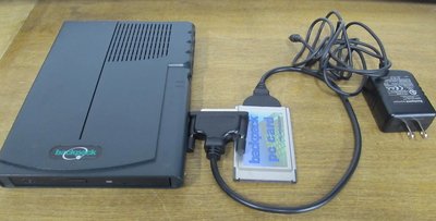

I have a backpack cdrom that I purchased to do installs on my old laptops that do not have cdroms.
However I do not know how to use this backpack cdrom device to perform a clean install.
Is it possible to create a bootable DOS floppy that loads the backpack cdrom driver ?
Then I can fdisk the drive , format it, and then run “setup” to install Windows 98se.
My backpack has a PCMCIA card connection and parallel port cable.

Here are the drivers and instructions on how to use it.

Okay, So I have to boot off of a bootable DOS floppy and then swap out floppies and run this "loadcd.bat" batch file ?
Thats what I mean, Can't I just copy these device drivers to a bootable DOS floppy and have autoexec.bat load the Backpack CDROM drivers ?
That way I only have to use one bootable floppy disk that loads all the drivers.

Yes, if the drivers are small enough you should be able to copy them to a boot floppy, add them to config.sys/autoecec.bat and use that floppy to boot with cd support. That's what I used to do with an external SCSI PCMCIA cd unit. It would need 3 drivers:
1. ASPI driver for the PCMCIA card in config.sys
2. CDROM driver in config.sys
3. Mscdex.exe or equivalent in autoexec.bat
The first 2 were specific for the hardware I was using, the third one generic from DOS or equivalent replacement (shsucdx for example)

You also might take a loop at PloP boot manager, it can run from a cd or floppy and initiate boot from basically anything, including USB on ssystems that don't natively subbort boot from external media. All it takes is for the drive to appear in the list (as in the BIOS has to recognise it)
