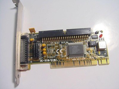

Reply 1 of 16, by Intel486dx33
I use the Tekram DC-310u Fast SCSI adapter. Good driver support.

Reply 2 of 16, by aries-mu
Wow! Does it support bus mastering?
Too bad you can't use solid state memories with SCSI controllers, so you're stuck with HDDs.
Unless you want to pass through the curse of the shamefully hyper-expensive Acard SCSI to IDE bridges.
