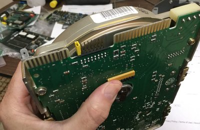

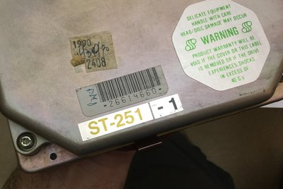

I am restoring a 286-12 and have everything running great except the hard drive and controller. I have a Seagate ST-251-1 MFM hard drive which seems to be fine (spins up, gurgles a bit and sits waiting) and I have a few controllers.

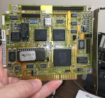

The first controller is a Western Digital WD1002A-WX which just burps out a 1701 error at post no matter what jumpers I have set.

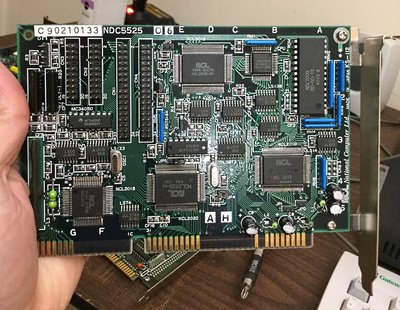

The second controller is a NCL NDC5525 which has a floppy controller and a MFM controller on the same PCB. This one boots from the floppy drive no problem, but I can't seem to get to its BIOS to setup the MFM hard drive. I've tried DEBUG with the commands G=C800:5, G=C800:6, G=C800:800, G=C800:CCC, but that just hangs the system. If anyone knows the proper debug address for this card please fill me in.

So if anyone can give me some info on that NCL card I would greatly appreciate it.
