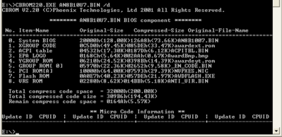

Ok, looked through my cards and I don't actually have any with the 3112 chipset.
However, after a bit of research, I did find out that the ASUS A7N8X Uber 1007 BIOS has the SIL 3112 4.2.27 BIOS embedded in it.
Here is where you can get a link that you can use in the wayback machine to download it - the newest snapshot of the file is corrupted so I had to go back to an earlier snapshot. Because of this, I am attaching the 1007 Uber BIOS to this post.
https://tweakers.net/downloads/5438/asus-a7n8 … -bios-1007.html
1007-Uber.rar
218.75 KiB
29 downloads
You will need CBROM to extract the SIL 3112 BIOS. It is available here:
http://www.lejabeach.com/CBROM.html

Reply 10 of 24, by konc
cyclone3d wrote:
Ok, looked through my cards and I don't actually have any with the 3112 chipset. […]
The attachment 1007-Uber.rar is no longer available

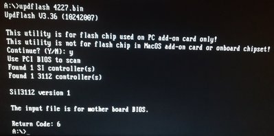

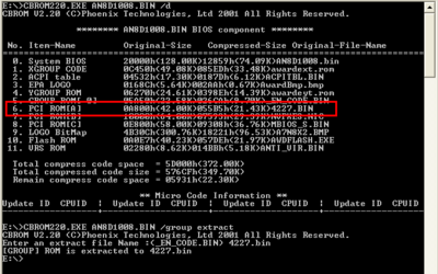

but you did put me in the right track in a way I'd never thought. So I browsed through the official ASUS support for this motherboard and after downloading and using CBROM to check a couple of older BIOS' I found one having the desired version and extracted it:
16.62 KiB
1637 views
It seems that the flashing utility is a bit smarter than it should though (or, most probably, prevents stupid people like me bricking their card) and recognizes that this BIOS is not intended for a standalone card:
113.18 KiB
1637 views
Damn that was close!

The 4.2.27 is in fact the add-on card RAID BIOS. And guess what? The damn thing works!!! Flashed it, reset, and it just booted and entered windows.
So it's true, they did break compatibility with older system with versions >4.2.27. If anyone has such a card and it recognizes the connected device but it hangs/freezes when accessing it (either attempting to boot or simply access a file after booting from another media), downgrade your BIOS to 4.2.27.
So let me just attach this hard-to-find BIOS here as well (origin is cyclone3d's link of course):
