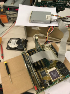

Reply 31 of 38, by tony359
I see, thanks! Well, I hope the regulator is all that is missing. I do have 5V as input so hopefully the output then goes to the VCC pins. I do see some resistors on the ADJ pin so hopefully that will work.
Edit: yes, the regulator output is connected to the voltage selection jumper and from the jumper straight to the CPU. Good times when you did not need stupid power and massive regulations for a CPU!!! 😁
Again, is it ok to see 5V on some other pins of the socket? I did not write down what those pins were but they were not VCC.
My Youtube channel: https://www.youtube.com/@tony359
Reply 32 of 38, by tony359
Update - I couldn't wait so I plugged my bench PSU on the CPU voltage pins (the jumpers on the MB) and gave those 3.3V - the PSU is fully floating so it was safe to use.
And it works! the MB was sold as "not working". I washed it and re-seated everything but also went through all the jumpers which were - IMHO - incorrectly set. Anyways, I have a working system! I should get the regulator soon so I can get rid of the external PSU! 😀

Reply 34 of 38, by tony359
Update
I have installed the regulator and it works like a charm with no modifications required. The board works fine. I will add a heatsink but it gets barely warm.
Thank you for the massive help!

Reply 36 of 38, by tony359
Ehm... I know it works because it boots up? 😀
Yes, I did check the voltages before fitting the CPU back and I have 3.34V in the socket. Then I booted up without the external PSU (and the jumpers set to 3.3V indeed) and it's working fine.
Am I missing something? 😀 I do not have a keyboard yet so I cannot go past the BIOS but I will fit a heatsink anyways.
