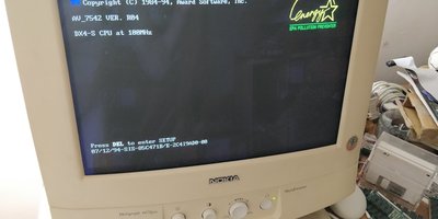

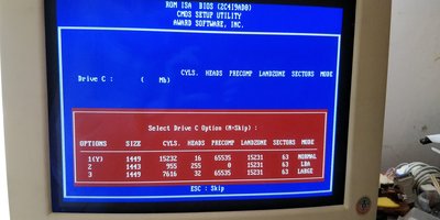

Reply 9 of 11, by Deksor
derSammler wrote:
Are you sure you are not confusing LBA with E-IDE? Until 1993, the 504 MB limit was still normal and was slowly taken over by E-IDE with the 8 GB limit. LBA was not a thing back then. LBA was introduced with ATA-1, whose draft was published in late 1994. No mainboard, or rather BIOS before 1995 can do LBA therefore. Now you may have a 486 mainboard from 1994 with a BIOS from 1996 or so which may added LBA. But it wasn't normal for 486 boards to have LBA. Even early Pentium boards had no LBA support.
Well not really, look at this :
1.61 MiB
613 views
1.07 MiB
613 views
12th july of 1994
Although there's few strange things about that : No matter what I chose, in the BIOS setup, the capacity is always wrong (it won't go over 2GB). When HDD is configured to "LBA", I cannot change the CHS settings anymore (and the capacity displayed is once again totally off : say for example 57MB for a 8GB SD card).
I guess this was implemented as an afterthought

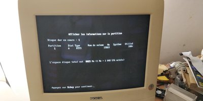

One more thing :
1.02 MiB
613 views
Fdisk from DOS 7.1 can't see past 8GB (I used a 40GB drive), so now I'm not sure ... The CHS settings are totally different from IDE or E-IDE in the bios, prehaps this is some "beta" version of LBA ?
