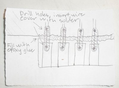

Reply 2 of 18, by kaputnik
Would have tried something like this:
Grind the rough edge as straight as possible, to match the new connector. Tape the new connector in position from the underside, this is mostly to keep the glue in place. Fill the joint with epoxy glue, put a piece of tape on the upside too, and let it harden. Once it has hardened somewhat, you can remove the tape and cut/grind away excessive glue. Then let the glue harden completely before doing anything else.
Drill holes as close to the connector traces's upper edges as possible, you don't want the solder blob to collide with the connector once you insert the card. Also drill holes in the traces leading to the edge connector, and remove the protective varnish around the holes with a fibreglass brush or a scalpel. Insert wires in the holes, try to get them as tight as possible, they will also add some stability. You could even do wire loops and twist the ends together on the back side of the card, will be even stronger.
Then cover the wires with solder, and you're done.
Did a quick sketch too:
    91.27 KiB
    1947 views

Reply 4 of 18, by gryffinwings
kaputnik wrote:
Would have tried something like this: […]
This is basically what I was thinking.
