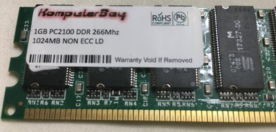

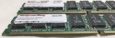

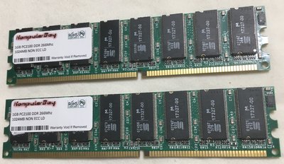

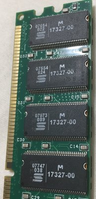

I have a couple 1GB DDR1 266 KomputerBay sticks that I pulled out of an industrial rackmount system because they were causing issues.
These pieces of trash actually have two RAM chips stacked on top of each other.
You can tell that that these are some sort of recycled sticks as the one chip on each of them obviously had some other sticker on them and they tried to rip the sticker off and place the Komputerbay sticker over them.
The white writing on the top layer of chips is also very obviously a remark because I can see the original engraving on the chips themselves. The top layer of chips are recycled Micron. Who knows what the bottom layer is.
STAY AWAY from Komputerbay !!!!!

What in the world?
I did had Komputerbay ram before with Samsung chips, but they were fine, I had no issues with them.
I wouldn't use them in systems that I often use but they were always fine for me to use in retro builds or thinclients.
I had some HP-branded ECC DDR1 sticks out of an EXPENSIVE dual-Xeon server that were built this way. I don't really know what that means. 😜
My Komputerbay DDR3 SODIMMs contain no such weirdness.
I'd bet anything they make "new" DIMMs by harvesting old chips from whatever they can get as e-waste. Nothing wrong with that in theory, as long as (a) your quality control is IRON-CLAD and (b) you're honest about it. Since they fail at (b), wanna guess how they score at (a)?
