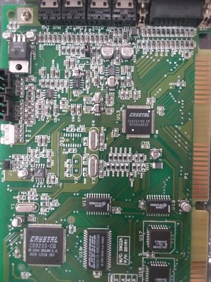

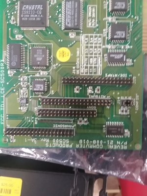

I came across this card and I can get it cheap, I'm just wondering if it is something special about it or is it a waste of money. My research is inconclusive. I've attached pics but the chips I see on it are all Crystal, CS9233-CQ, CS4232-KQ and CS4112-CS.
Here are some pics of it, sorry if they are a bit fuzzy

So I decided to get it but I can't seem to find a good set of drivers for it. I've gotten what I can find which is a few zip files. I do still need to test them.
Does anyone know what happened to Reveal Computer Products? I found that Creative tried to assimilate them into the "Creative Collective".
What I do know is that this is a SC500 Rev. 3A-1 P/N 21-008-018 might have either been part of a CD-ROM drive & sound card bundle, sold separately as a SoundFX WAVE or both.
