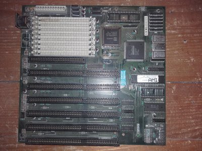

Found this board in my basement few days ago. Seemed interesting 8 simm sockets, 25Mhz cpu, I have a nice working ITT 287 for it etc.
The board says MG PRODUCT MG-2862002 REV. 1.2
After brief inspection I figured out that some parts are missing, BIOS ROM, jumpers, maybe something else I don't know.
Chipset is Headland ht21 and I found one rom file that may be the one (2hlm004.zip), the board has only one ROM chip 27512.
I couldn't find any info on jumper setting so anyone with any ideas is welcome to jump in.

BIOS rom? But what is that with the word "AMI" ? It is a BIOS, but is it for keyboard ONLY?
Or actually the OPTION ROM is what you thought?
THe BIOS Battery (or the battery holder ) recommended to solder where it is marked that "lithium 3.6V".
When having following expansion cards: one multi IO controller; display card; and one memory simm, then it can be checked already though?
if you need the EPROM burning then with that I could help, also I have fresh blank chips.

Reply 4 of 22, by Jo22
My guess is that this is the keyboard microcontroller (8042 derivative). Not sure why it has an AMI label onto it.
I've seen that quite often in the past, still makes no sense to me.
Maybe AMI also made custom firmware for the KBC ? 😕

Reply 8 of 22, by kokerich
Thanks for quick help there.
First of all AMI chip is keyboard bios only, the board needs EPROM for SYSTEM BIOS which is a totaly different thing. But I think it would not be a problem, I have a bunch of good EPROM chips and a good EPROM programmer and even the file that I found is one file instead of two (64k instead of 2 x 32k). The only question is whether the file is apropriate for this MB. In other words do all the boards with ht21 chipset have the same ROM?
We'll see after burning the ROM if the board wakes up. I also have the NOS lithium 3.6V battery to solder, no problem there 😉
Hopefuly in the end we'll se how to fit FPU with it's oscilator.
Right now the only problem are jumper settings, I looked at th99 and I couldn't find anything, I'll look again.
Maybe we could guess some of them:
JP10 could be external/internal battery connector/switch
JP3 - oscillator for the FPU (if the clock is the same than it uses internal, CPU's frequency)
JP4 is maybe mono/color or something
JP5,6,7,8,9 probably speaker, turbo, keylock, reset etc.
JP11 have no idea.
TP1 maybe CMOS clear.

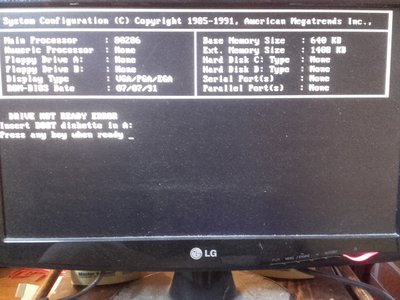

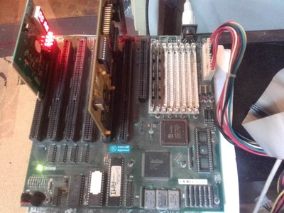

OK, here is the update, after I programmed EPROM with 2hlm004.bin 64kB file the board woke up, memory test passed, got to the point of OS loader. The only thing suspicios is the speaker which beeps short beeps repedeately. Still there are mystery jumper settings that I'm worried about, and about inserting FPU unit, I am not sure whether it uses onboard oscillator or I need to plug in one more.
Also I woud like to test the motherboard so it would be nice if you can recommend me some good tools for that.

25MHz 287s don't exist, so unless you're OK with overclocking the one that you have, you will need to plug in a suitable oscillator for your 287.
I am well aware of that fact, my IIT is rated 20MHz so maybe it can pull it out on 25.
Still I have a dillema. There are three crystals on board: one standard 14.318MHz, one on 50MHz (obviously for the main CPU) and one on 32MHz maybe for a FPU.
I've seen boards with three crystals without a socket for a custom crystal for the FPU. Usually the third crystal is for the FPU.
Also there is a mystery jumper which I guess is for clock selection for the 287 (onboard crystal or added).
Still I guess the best solution is to get 40MHz crystal and insert it into the socket. I guess there is a way to somehow check the clock of the 287 in software.
In the meanwhile I tried to test the board but I ran into problems.
The problem of short beeps disapeared when I put the jumper on JP4 right beside the keyboard BIOS. Still I don't know the meaning of this.
Real problem is the keyboard. After starting up, the keyboard works just fine. I can enter the CMOS settings and diags move aroung for ever, everything works.
But when it reaches the point of loading OS the keyboard stops working while the system is running further, machine does not freeze, it boots the DOS with no problem.
Diagnostic card shows no problem.

Can't you measure on pin 32 of the FPU socket what clock is fed to the FPU? Needs an appropriate multimeter or logic analyzer... 😀

When I remove the JP4 everything works the same but there are endless short beeps comming out of the speaker (very anoying). Nothing to do with the keyboard fail.
It's interesting that while in setup/diags of the BIOS, keyboard can work for hours but when OS stars to boot it stops immediately (strange).

In the meanwhile I traced the PCB which confirmed what I thought earlier. Third crystal (32MHz) is traced to the JP3 which selects between that crystal and the one in the Y4 thus selecting the frequency for 287.
No worries about FPU, the keyboard is the main problem now. 🙁
