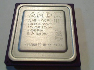

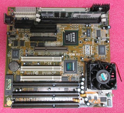

Okay, I have all the parts in and am ready to finally build an AMD K6-3+ / Voodoo-3 computers.
Here is a list of parts I have.

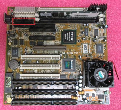

Motherboard - Soyo SY-5EHM
CPU - AMD K6-3 450 going to over clock to 550mhz.
RAM - What kind and how much do I need ?

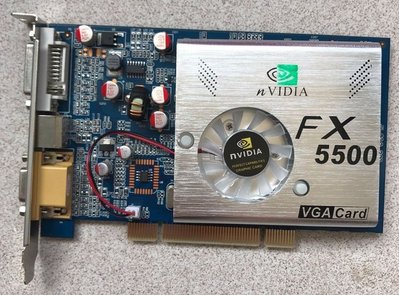

Graphics - Voodoo-3 3000 AGP or Nvidia FX5500 ?

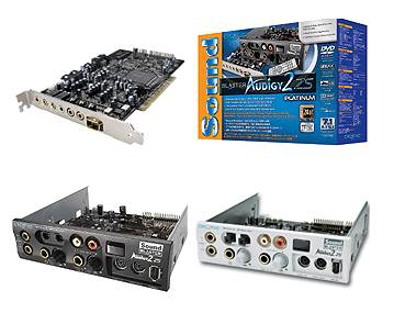

Audio - Sound Blaster Audigy 2zs or AWE 64 or SB Live 5.1 or Yamaha YMF-7xx , SB Pro 2 .
Network - Intel 10/100

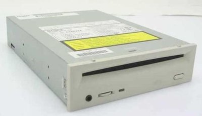

CDROM - Sony Slot loading 16x
HD - 160gb 72000rpm Seagate.
PSU - 500 watt ATX
Case - Lian Li
OS - Win 98se or ME ?
What do you think ?
What parts should I use ?
What to avoid ?
How to make this the best build ?

Reply 2 of 30, by 3dprophet
I think in Phil's Computer Lab benchmarks Voodoo 3 AGP had about the same performance as a FX5500 PCI on a K6. I would choose the Voodoo 3 for Glide support and period correctness.
SB Live 5.1 is the best all-round card and would be my first choice. It is also period correct. Audigy 2 ZS is best for Windows 98, but it doesn't have DOS support.
Windows 98 SE for best compatibility and DOS support.
256 mb of ram. More than enough for Windows 98 without running into too much memory issues.
Reply 3 of 30, by The Serpent Rider
It does. Audigy drivers.
They're not practical and completely outshined by Audigy series in every aspect.

Having build a very similar system, I'd' say that:
256MB or RAM is plenty, just try and get CL2 if possible.
Definitely go with Windows 98SE and use the unofficial service patch. This way DOS won't be a problem.
For graphics, I had a similar dilemma. Given the numerous issues with early AGP chipsets, I'd stick with the Voodoo3.
It has perfect DOS compatibility and is plenty fast for what an AMD K6-III+ is capable of.

Reply 8 of 30, by tpowell.ca
Intel486dx33 wrote:
Oh yeah, I forgot. I also have a sound Blaster Pro 2.
I think I want a card with midi support built in , so a Yamaha Ymf chip is a must.
I tried an SBPro 2 and it didn't work for me. Apparently, this and earlier cards can be picky on faster systems (Pentium and up).
As for fitzpatr's comment, I agree. If 2+ cards are an option, then absolutely an Audigy or Vortex2 are the way to go.
May I also add, that I don't care for period correctness what-so-ever. And with that in mind, may I suggest to also get a PCI IDE controller such as a Promise Ultra 100 or 133. These help with issues on larger disks and can handle anything you through at them except for CD-ROM drives for which you still use the on-board controller. With Bus Mastering and great Windows 98 and DOS compatibility, you won't regret the speed boost.

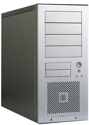

On a different note, congrats on that case. I'm jealous, but too bad your mobo is AT and not ATX. It'll make things a little more annoying and unless you have an AT/ATX coverplate you'll have a big hole in the back of the case where the AT keyboard connector is.
Yes, The more ventilation the better. They sell blank I/O covers on eBay for about $3
I like working with Aluminum case because they are light and usually precisely made so everything just seems to fit and work.
They cost about the same as a retro AT case so I would rather go Aluminum.

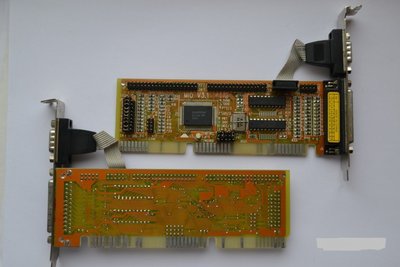

Case - Lian Li
OS - Win 98se

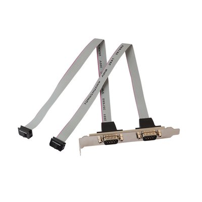

Okay yeah, I am going to save the SB Pro 2 for a 486 build. I used an SB live 5.1 PCI card instead.
Works good. I put the computer together last night but I ran into a problem. I have been having this problem with the serial port ribbon cables.
They don't seem to work. When I hook up my serial mouse it does not work. So I used an ISA controller card with serial ports and it works.
In Windows 98se all 4 of my serial ports are working. The on-board serial ports and the ISA controller serial ports. They all show up as good and working correctly.
So I hooked up my serial port ribbons to the ISA card and the mouse did not work. So the problem is the ribbon cable.
I just bought these NEW they are Dual DB9 (RS232) 10 Pin serial ports. My motherboard serial connectors only have 9 pins ?
I don't know if the pin out is different or not ?
Where can I get the correct serial port cables ?
    691.75 KiB
    1550 views
Reply 18 of 30, by dr_st
No ISA sound card? So you don't plan to use this system for pure DOS gaming, only from within Windows?
On a system like this I would prefer a PS/2 mouse, but I guess the AT board is the limiting factor here. You'd need a PCI to PS/2 card, and a lot of your slots are already populated...
Reply 19 of 30, by Intel486dx33
I purchase 4 of these boards slightly used from eBay. They look NEW like system pulls from computers that where never used.
However I only received the motherboard with no peripherals or accessories.
They do have connectors for PS/2 mouse and serial ports too. But no I don't have any compatible connectors.
Okay then, I might add a Sound Blaster AWE 64 ISA or Yamaha Audition 32 YMF-7xx ISA card too.
