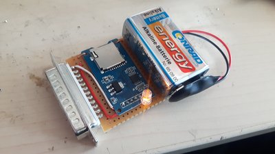

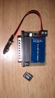

Hi,
i made a little Adapter allowing connection of a microsd card to the lpt printer port.
due do the fact chinese microsd modules with levelshifter are cheaper then a single mmc slot, i used a ready made module 😀

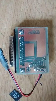

simple single sided PCB.

For Homemakers:
etch me.pdf
73.42 KiB
304 downloads
i used this Adapter:
https://www.ebay.de/itm/5Pcs-microSD-TF-Card- … 872.m2749.l2649
Note that this is not very fast, around floppy drive speed, depending on cpu speed.
And here is Nilquaders Driver, its most stable one i found.
There is also SPPD 1.1 Driver which runs also with some SDHC. i need to swap two Pin's in Code so both drivers can be used.
Swapping MicroSD is not possible without powercycle.

Reply 3 of 19, by matze79
its very handy, very small but slow.
But its much better to install borland C 3.1 from microsd instead of changing several floppys 😁
Or if you have a XT Clone with floppy only.. or a XT with 360Kb floppy and you simply want to drop some files easily.
The "Nilquader " Driver needs only ~1,5k RAM and implents SPI in Software on LPT.

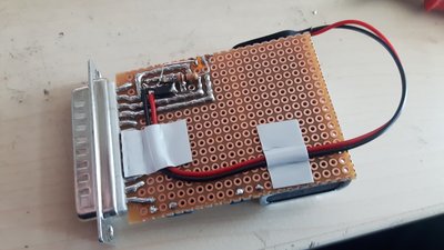

Here is my ghetto breadboard version of it 😀

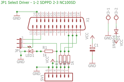

added 3 Resistors, fixing issues with my XT Computer, (SDCard not detected) added Select Jumper for Driver.
Simply switching the Pin's inside the sdppd Driver Source did not work, don't know why, and did no further investigation.
Used a 16GB SDHC with 32Mb FAT16 Parition and SDPPD Driver v1.1 😀
