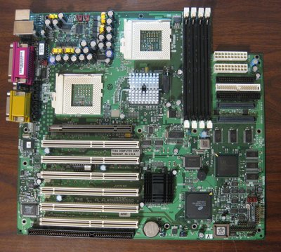

I am trying to get a Tyan Thunder HEsl S2567 motherboard working with dual PIII-S 1.4 GHz CPUs. I am using two Powerleap PL-Neo/T FCPGA-to-FCPGA2 adapters to facilitate Tualatin use on the S2567. According to the product sheet provided by Powerleap, these adapters have a fixed VID request of 1.55 V. http://www.powerleap.com/pdf_files/PL-NeoT.pdf I'm not sure why Powerleap wanted to set it for 1.55 V. From what I can discern, the PIII-S runs at 1.45 Vcore, while the Celeron Tualatin runs at 1.5 V.
When I view the PC status page in Tyan's BIOS, it says that the CPU's Vcore on one CPU is at 1.60 V, while the other is at 1.62 V. Has anyone run these chips long term at 1.62 V? What was the outcome? I've only ever run these at 1.45 V.
Do the Korean Tualatin mods have a non-fixed VID setting to allow the CPU to request the voltage from the motherboard's VRM?
As far as I can tell, the Thunder HEsl does not have built-in Tualatin support and I do not plan to test my luck putting the Tualatin's in the MB without an adapter. Tyan later released the HEsl-T for Tualatin chips.

That's merely 10% voltage increase not including Vdrop. Should be absolutely fine.

I did find the spec sheet previously and saw the "Absolute Maximum" Vcore setting of 1.75 V, but it seems like it is awefully high. It wasn't clear if 1.75 V was OK for sustained use. Normally, it seems CPUs have about a 0.1 V, above and below the target voltage for which they can run at. In this case, it is 1.45 V. So I was wondering if anyone has run these at at least 1.6 V for a sustained period of time, meaning years, as a daily driver? I suspect those who ran these in slockets or s370 adapters may have run into this, especially if using the PL-Neo/T.
I'm running Memtest 4.20 on the system now to find the optimal chipset settings. Using 4 GB reg/ecc. There seems to be something wrong with CPU2's temperature sensor because it always shows 92 C, while CPU1 is at 50 C. Perhaps something related to the Neo/T? Do these chips have
built-in thermistors or could the issue be on the MB?

It is normal for 130nm CPU. Barton works at default 1.65v without any problem.
