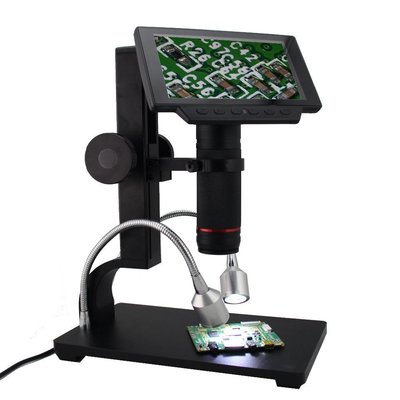

I am NEW to soldering.
I recently started to learn how to solder repairing old electronics and computers.
I hope to build a good soldering work area in the future.
What Iron to use ? Currently I use an inexpensive $20 iron.
What Solder type? 60/40
What Flux type - SRA , Kester, Paste, No-Clean
What WiCK ? - Copper
What USB Micro soldering station -Andonstar 5 inch Screen 1080P Digital Microscope HDMI Microscope for Circuit Board Repair Soldering Tool ADSM302
What USB MicroCamera - Plugable USB 2.0 Digital Microscope with Flexible Arm Observation Stand for Windows, Mac, Linux (2 MP, 250x Magnification)

Huh. That's very interesting. I have a logic board station and solder station that holds wiring in place (what I used when I made my own A/V cable for my Commodore 64).

Magnification, any magnification, is very handy. As for which soldering iron to use, I have a Hakko FX-888D (which is excellent) and a 90W Chinese STM32 based T15 iron (this one - I like it better than the Hakko).
