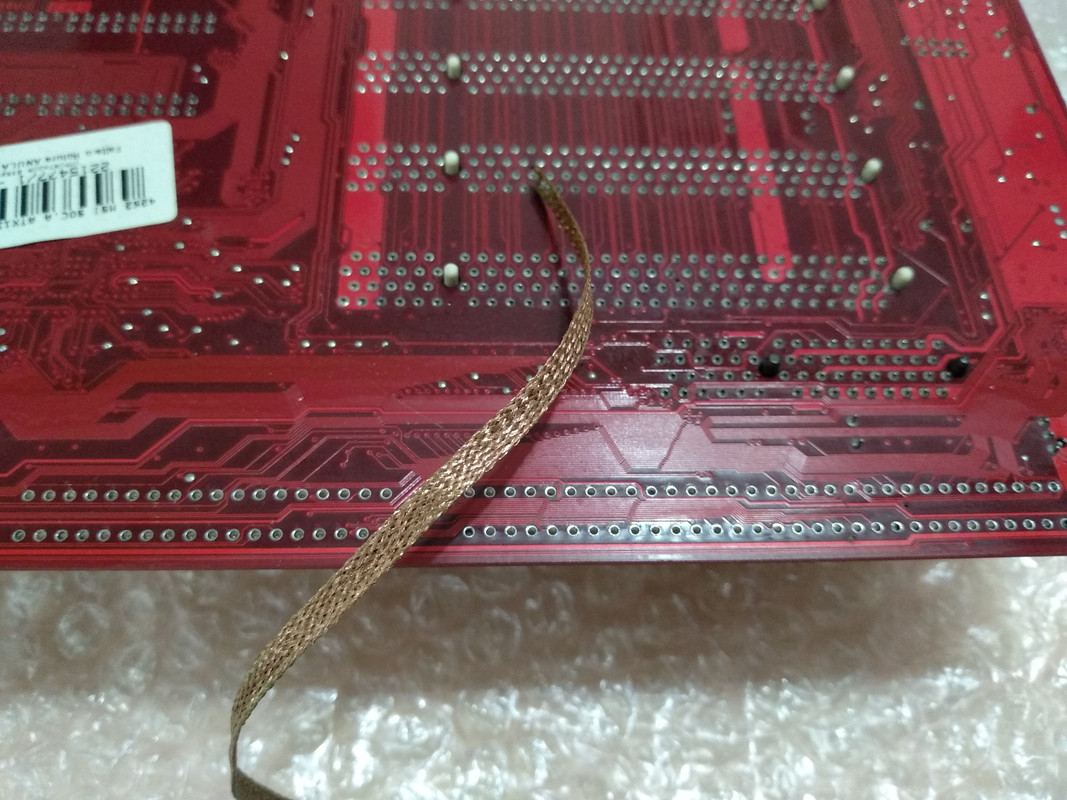

i have one of these on a box and i always wondered if the ISA slot is usable or not.
I read the manual long time ago and the manual says the isa slot is "optional" The motherboard also has drivers for practically everyhing since win98.
Im wondering if this motherboard, which can be very cheap and easy find, can be upgraded soldering an ISA slot into it and make it work.
The last bios also supports up to Athlon XP 2600+
My board also has 2 missing capacitors, probably i took them out and never replaced them, now i dont know what uF and voltage they are, if any of you know the ratings of the capacitors i would really appreciate it.

I will try to desolder the slot and solder an isa slot taken from another motherboard

i spent about two hours yesterday with soldering braid. about one hour to take an isa slot out of a dead motherboard and another hour to desolder the holes on the msi board
tonight i need to test it with a cheap soundcard i got at home. i hope it works because it was a pain in the ass to do this

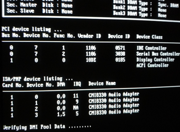

so sad, after playig a couple hours with different soundcards, no go. I did get a SB vibra working on the ISA slot but vibra is a shit card with bad sound quality. The mod was done to have a good card on it.
tested a bunch of cards, audioexcel, ALS007, awe32...i did not have a SB16 with jumpers at hand.
I practically changed so many things in the bios but there was no change, setups refused to install. DIssabled practically everything, onboard sound, serial, lpt, changed IRQs to PCI-ISA, then to legay ISA and no luck. I had the setblaster on autoexec and nothing worked.
I think the bios is capped somehow, maybe there is a way to mod it?. Because when i try the audioexel card on a super socket 7 motherboard , i do get the ISA PNP listing on boot...like this picture below: and the card works without installing anything , just with the setblaster line and you are good to go.
whith the MSI motherboard i only get the "PCI device listing" and not the "isa device listing",
on pci listing it shows an audio device but i think it might be the internal one since if i disable the onboard chip sound on bios it dissapears.

the strange part is that the bios has the option for PNP PCI ISA and Legacy ISA, but it just doesn't work, when i disable practically everything, the sb setup fails to detect the 220h
Maybe there were some electronic components missing with the non-isa version, but how come i was able to make a vibra work and not the other ones is a mistery.

One thing i noticed was that as i explained, i was able to get PNP sound out of a Vibra soundblaster card.
The strange part was that..
Sometimes when i booted i saw the ISA PNP list on boot below the PCI pnp list (like in my picture above using another motherboard k6-2), saying the IRQ and the name of the card "Vibra 16x..." or something like that.
Then i booted another time and the ISA PNP didn´t even show up on boot
>Then i booted a third time and the ISA PNP showed the card but not as vibra 16x , it said "audio".
I wonder if proper voltage is going to the card, maybe some component is missing. how come the ISA PNP boot menu appears at random if im not changing anything just pressing alt control delete.
With other cards I never got the ISA PNP list when i booted the pc. and all attempts to install using SB DOS drivers failed 220H

It looks like the board has all needed support components for the ISA slot to work. My guess is that the southbridge is just not fully configured to enable all ISA functionality and this is a BIOS shortcoming. It would be possible to write a DOS util that does the init.
Reply 19 of 40, by Roman555
I saw all K7T on MSI web site. There's no another board that has an ISA slot or ISA footprint.
And there's no special BIOS for ISA slot model on MSI web page for K7T Turbo2.
In the worst case my guess is BIOS could read some DMI data. If it finds an ISA slot feature it turns on ISA support.
So the manufacturer doesn't need different BIOSes for optional features.
