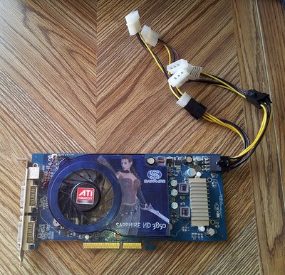

I forgot about this. Was taking apart my dearly-departed Socket 478 gaming rig and pulled this octopus out:
457.86 KiB
1533 views
That would be four MOLEX connectors, adapted to two 6-pin PCIe, to one 8-pin PCIe, to run this monster card off a crummy 2003 Enermax PSU that's never even heard of PCIe. There was also a MOLEX to SATA adapter in the mix to run the DVD-ROM. 😜
Surprisingly none of this killed the system (and the GPU still works fine.) It was possibly the well-known Intel ICH5 ESD failure, but I'm not going to put a whole ton of work into diagnosing it.
What's the worst hack you've put into a build?

I have this same card, I use it with an 8-pin to 2 Molex adaptor..
Let's do some math. the PCI-Express HD3850 uses a 6-pin connector, rated up to 75W. The PCI-Express also delivers 75W max, so it's a total of 150W.
The AGP port delivers 20W, so you need 130W from the power connector. That results in the requirement for an 8-pin connector (150W max). That means in the worst scenario you would need 65W from each Molex if you use a 2 Molex splitter. Is this possible? Kind of, the Molex plugs can carry up to 60W on the 12V rail.. However they are rated up to 40W, so the safe-use case will bring around 80W from the 8-pin, and when you add the AGP power that makes 100W.
That is probably enough for an HD3850 though, as it is a 75W TDP part. Granted, that is thermal dissipation and is related mostly to GPU power consumption.. Add 20-25W for memory power and you should be able to squeeze the HD3850 into the dual molex envelope if you are feeling adventurous. Case in point: X1950PRO AGPs, which are 66W TDP parts, are comfortable with 6-pin or dual molex power.

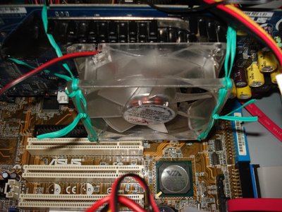

Reply 14 of 18, by Tetrium
The worst? I don't know.
But I used this cooling solution a couple of times. Worked flawlessly for years 😁

Oh yeah. Been there, done that. For me it was on a CPU cooler with a weird form factor whose original fan failed. Ziptied a 80mm case fan on top after removing the failed fan, worked like that for years. Easy to replace too if it fails again.

This card actually works fine with just a 6-pin connector plugged in.
You can also use a single 6-pin to 8-pin adapter if you want to feel "safe" while using two fewer Molex connectors (the card originally came with one).
