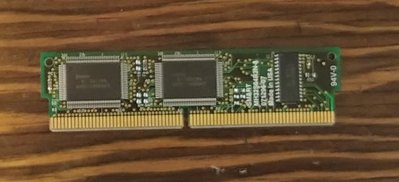

Hello! I have an Amptron DX9700 rev. 3.2 motherboard, and it has a cache module. Or at least what appears to be and my cache stick fits but it does not work. Further investigation lead me to this page: http://th2chips.freeservers.com/m919/
Where it states the cache module is not a cache module and a cache module will not work. It doesn't state why though. Im just curious if anyone knows why and has come across similar things.

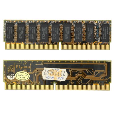

This is actually a PC-Chips M919 motherboard.
It uses a proprietery connector for the cache stick, and is absolutely not compatible with Pentium/socket 5/7 style COAST modules.
Unless your module looks something like this:
637.66 KiB
557 views
I would advise against using it.
If it does look like this, how did you confirm that it did not work?

Reply 2 of 5, by M4tthewd
Exactly like that? No the one I have I've attached a picture. When I installed it, the pc wouldnt boot or post at all. When I took it out it did. Repeated to make sure it was seated properly and same result.
Reply 3 of 5, by tpowell.ca
That is a Pentium-generation COAST module.
You're lucky your board didn't go up in smoke with that installed as the pinout is completely incompatible.
