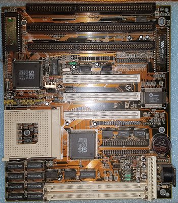

Reply 27 of 30, by Baoran
I went and got the motherboard today. It almost looks like it is brand new. This is the smallest and cleanest such old motherboard I have ever seen. I hope it will work. and I will see what kind of hard drives it likes.
