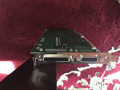

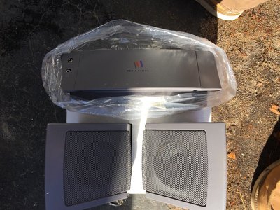

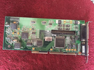

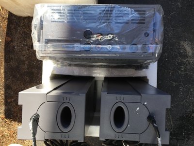

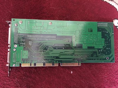

A few pics from the seller:
487.28 KiB
1673 views
422.52 KiB
1673 views
267.97 KiB
1673 views
379.64 KiB
1673 views
257.9 KiB
1673 views
Behind the front of the unit hides the CD-ROM drive.
