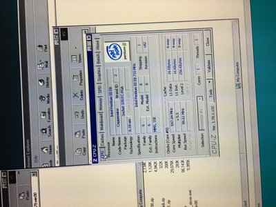

Just wanted to make sure before I end up making a big deal out of this.
I got my MSI-6905 Master w/ socket 370 CPU today. Ran CPU-Z on it, and it identifies as a Pentium III EB 733Mhz, although the auction description listed it as a 1Ghz chip. Right now its running at 550Mhz as per mobo FSB but obviously not showing up as a 1ghz chip either way. (POST screens caps at 500Mhz)
I suppose short of taking the HSF off there is no way to really tell for sure, but I I'm curious about ebayers who have had to deal with auctions sold "as is" yet with incorrect information like this.

cpu-z will use CPUID instruction to identify the actual cpu + and its capabilities. you can take its results and go look them up if you dont trust CPU-Z

I might be wrong but as I understand all pentium III cpus are multiplier locked, so if multiplier of your cpu is 5.5x, it would be 550Mhz at 100Mhz FSB and 733Mhz at FSB of 133Mhz and that would make it a 733Mhz cpu.
If I am wrong, I am sure someone corrects me.

I'm not positive about the lock (but pretty sure you're right) but yes there are 100mhz and 133mhz bus flavors. As said above, there is a CPUID instruction on processors going all the way back to the original pentium that cpu-z is "calling" which returns everything about the CPU including it's stepping, model, type, etc. If his motherboard is running at 100 bus a 1ghz cpu would run at 733mhz as you say(unless there is something up with the board or it doesn't support his model? or its running at 66mhz bus?? ). I suspect we're also talking about a P3 733 here though.
I do think CPU-Z shows the current operating speed but the specification up top should show more exact information. Is there any kind of Model showing in cpu-z you can go ahead and paste in google to check? Otherwise, I would pull the heatsink and check, it wouldn't hurt to put some fresh thermal compound on it anyway in the process of verifying seller didn't lie to you.

here ya go.
edit: ugh I don't know why this board software always shows it rotated when the full size is shown proper orientation... plz click on it, thanks

Yeah given that information and your bus speed I'm confident you have a 733.
Looks like the first stepping too
www.cpu-world.com/CPUs/Pentium-III/Inte ... 256E).html
On the black part at the bottom of the die you would probably see QM51, SL3T4, or SL3VM.

I was offered and accepted a $15 partial refund. now I gotta decide what I'm gonna do with it, 🤣. I guess I could just keep it in this machine for now and hang on to it for historical reasons.
I've never owned a 1st stepping CPU before.
