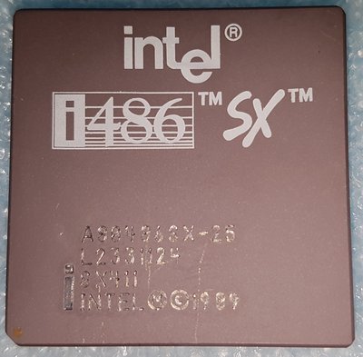

Reply 4 of 6, by Baoran
Here is the 486sx that I was planning on putting on a 486 motherboard that should be coming in few days in mail.
I have no idea if it has FPU or not.
1.64 MiB
294 views
I am bit curious about the 1989 year on the cpu because as far as I know 486sx didn't exist in 1989. Anyone has any information about that?
Reply 5 of 6, by SW-SSG
^The year typically refers to the date of first release of a particular architecture or CPU family (80486 in this case), AFAIK. The "233" in the second line points to your particular 486SX as having been manufactured on the 33rd week of 1992.
Reply 6 of 6, by Koltoroc
Baoran wrote:
Here is the 486sx that I was planning on putting on a 486 motherboard that should be coming in few days in mail. I have no idea […]
No 486SX has a usable FPU. They are either fused off in early models or not present at ll in later models.
