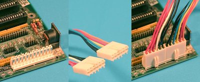

Reply 3 of 12, by Neco
Could this be the result of incorrectly plugged in power connectors?
They need to look like this FYI... I don't recall if I've ever owned a board that had both AT and ATX power connections. Didn't think they existed but I am getting old, so....
a complete parts list of what you have might help too.
Note the order of colored wires.

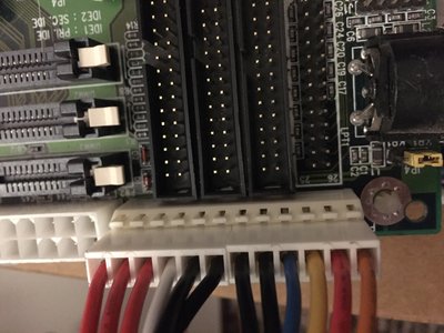

I tried the board with an ATX power supply and I’m getting clicking seemingly from the PSU. I’ve attached an image of what it looked like for a sanity check.

Reply 5 of 12, by Strahssis
I have had an issue like this before as well with my ATX-power supply; when I turned it on I'd also hear a ticking noise.
It turned out that my 4-pin cable wasn't installed correctly. So I'm guessing you've got a connection issue, though it seems you have installed everything correctly. Maybe there is a broken connection in either the cable, power supply or motherboard?

Reply 6 of 12, by TheMobRules
The ticking sound is usually due to the power supply refusing to start because there's something shorting to ground. It is probably also why the AT PSU caused the fuse to pop.
Start by checking resistance with a multimeter in the power connector of your motherboard between the different power rails and ground, you may find a short there.

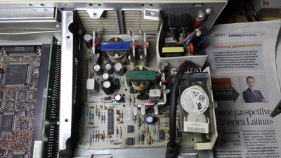

The shorts. Good Lord.
I have this compaq this 386. (see pic) Fuse inside PSU shorted.Replaced it ,and obviously shorted again.
666.56 KiB
724 views
Had the great idea to replace it with a piece of metal (sigh and 🤣) . PCB traces from fuse to PSU mosfets MELTED and sparkled into a fiery plasma fire. Magic smoke everywhere.
That's when i've learned about checking ALL main PSU components, and if there are shorts on the board,well, you have to replace that component...
Found that the bu-508 (main mosfet of that PSU) was SHORTED between base and emitter (NO POWER IC'S should have shorts between 2 of their 3 pins!) Replaced it with a similar one from a scavenged Television power supply and the 386 worked again!!
I don't know what's the origin of your problem, but be careful when using old PSU's!
If i may help you:
1. AT PSU. Check it barebone. Nothing attached.Switch it on. if it works and fan spins: Mobo problems, or peripheral problems.Then try with only mobo, and eventually plug all your isa cards one by one.
2.If AT Psu shorts immediately, check for swollen capacitors and shorted Power IC's (mosfets an voltage regulators) on the power supply board.
