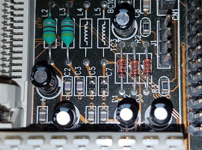

I did check it out the best I could and this was only thing I was able to find:
1.64 MiB
990 views
The topmost capacitor does not seem as shiny as the others to me.
Anyone knows if that is just corrosion on top of the capacitor or if it is really broken?
Reply 4 of 29, by Baoran
shiva2004 wrote:
It doesn't look good, that's for sure. What's the brand?
Also I don't know if it's the photo, but I don't like the look of the diodes just below it either.
Diodes are probably ok. At least my multimeter gave me a beep with each of them using diode test mode.
Reply 5 of 29, by keropi
It could be the board sends too much voltage to the simms and slowly kills them. It would be very unlikely that cap is to blame, it seems to me it's just a filtering one.

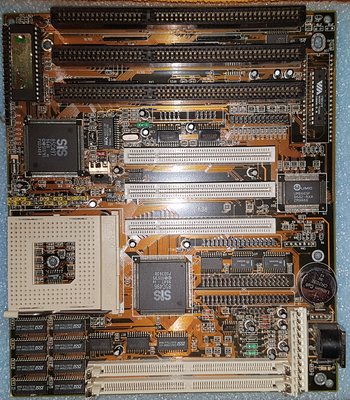

This is the motherboard.
1.81 MiB
872 views
And when I got it, it came with two 72 pin 16Mb 50ns edo ram modules. It says HTEC TBS6416B4C50 on the chips of the modules.
At least I know now that they are bad because of all the errors I got with memtest86+ with the socket 5 motherboard. Only thing I can't be sure of is if the motherboard broke them or if they were already bad when I got them.

Reply 16 of 29, by The Serpent Rider
That is LuckyStar LS486E, Revision D. Not EDO compatible.
Reply 17 of 29, by Imperious
I have that exact board and Mine works perfectly with EDO ram, it has I think the latest version of the SIS chipset that supports EDO.
http://www.elhvb.com/webhq/models/486pci/ls486ed.htm

That picture was the original socket 3 motherboard that I suspected that broke the memory modules and gives memory test fail error at post. The socket 5 motherboard was a pentium motherboard that I used to try to verify if the edo ram modules that came with the socket 3 motherboard are really bad or not. Even if they passed the post memory test on the socket 5 motherboard, I got hundreds of errors in memtest86+. I would be really happy if there was nothing wrong with the socket 3 motherboard and it doesn't break any other ram I might try to use with it.
Not sure how I could test if the ram is actually fake or not. They have 3 of those Htec chips on both sides of the module and the text is very faint on most chips.
