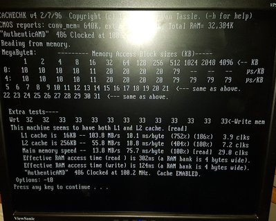

I did run cachechk on a amd 486 cpu and I got really unexpected results.

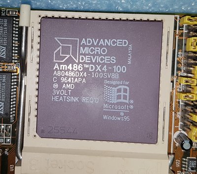

Here is the cpu:
821.17 KiB
1470 views
It is suppose to be same as this cpu on wikichip: https://en.wikichip.org/wiki/amd/am486/am486dx4-100sv8b
And based on that it is suppose to have 8Kb cache
And this is my cachechk result:
1.66 MiB
1470 views
Can anyone explain this or is it just simply that cachechk is wrong?

After Intel came out with their 486 CPUS with 16kb L1 cache, AMD followed suite.
Yes but this is Am486DX4-100SV8B
And the 16Kb version is suppose to be Am486DX4-100SV16B
Reply 6 of 15, by cyclone3d
Baoran wrote:
Maybe you've got one from one of the first few runs. Or maybe somebody messed up and had the wrong thing printed on a run of them.

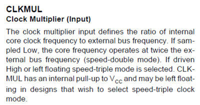

Reply 10 of 15, by gerwin
realoldguy23, see the nice 486 pinout summary in this link:
http://ps-2.kev009.com/eprmhtml/eprmx/h12203.htm
The ones with a CLKMUL pin have it for a reason.
Reply 11 of 15, by realoldguy23
Thanks, gerwin. Didn't know that. I only had a 486DX2/66 at the time, which doesn't have this pin, but the DX4s from Intel and AMD have it. Anyway, the pin only switches between 2 times and 3 times clock multiplying on them (not 4 times as stated above). This time, I'm sure since I googled first and the datasheets are very clear on this. 😉

I don't think that is true for all Intel 486 DX4s. This is from the "EMBEDDED WRITE-BACK ENHANCED
IntelDX4™ PROCESSOR" datasheet from October 1995:
17.04 KiB
1114 views
And this if from the "Am486® DX4 3-Volt Processor - High-Performance, Clock-Selectable, 3.3 V, 32-Bit Microprocessor" datasheet from July 1995:
19.08 KiB
1114 views
It seems AMD even copied the datasheets...

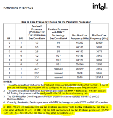

But you never know. A little story on the side, I hope the TO doesn't mind if we deviate a bit from the thread's topic.
I recently acquired a Biostar MB-8500TVX Socket 7 main board. It was designed at a time when MMX processors where announced but not available yet, but it stated it would support them (i.e. providing split voltage support).
I had an AMD K6-200, a P200 non-MMX, and a P200-MMX to try it out. All of them worked, but the P200-MMX was only running at 166MHz, while the other 2 CPUs were running at 200MHz with the same multiplier jumper settings. I suspected that one of the BFx pins of the CPU was defect until I found this:
68.05 KiB
1114 views
The board obviously pulled the BF down when the jumpers were set and left them floating when the jumpers were not set. (I confirmed by measuring it btw.) To overcome the limitation with the P200MMX I soldered in 2K2 pull-up resistors to BF0 and BF1 and now my P200MMX runs happily at 200MHz.
I think there were so many CPU types from so many manufacturers during the Socket3 to Socket7 period that it is nearly impossible to know everyone of them. But that's part of the fun, isn't it? 😀
