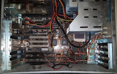

Here is a picture of the pc. It did come with a cd-rom, but no hard drive. I have not done anything to it yet.
