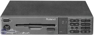

Yes, I read in another post that eh HXC SD slim has been proven to work, this uses an SD card, the SB-55 has the floppy unit behind the front panel of the unit, this means that I might get the SD card in but looks like once in it might not be easy to access to get it back unless I use some tweezers?
see image to help illustrate what I mean
