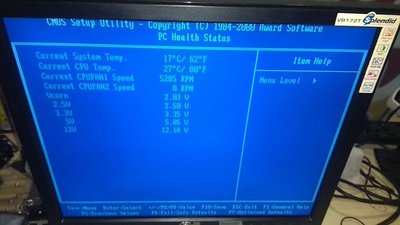

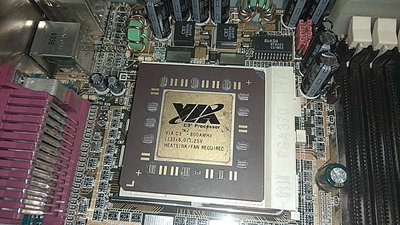

Today I received a Via C3 800A Mhz (133x6.0) at 1.25v
According to the info I found arount it's probably an Ezra-T, since the classic C3 at 800 mhz is rated v1.65.
The problem is that the mb select automatically to give him v2!
I tried to change the jumpers setting according to the manual but the voltage doesn't change.
The manual for ver2 is here: ftp://infomag.cz/ovladace/manualy/lucky%20sta … /6va694-v20.pdf
I use the A3 bios revision which is, I suppose the latest version.
Any suggestion is appreciated.

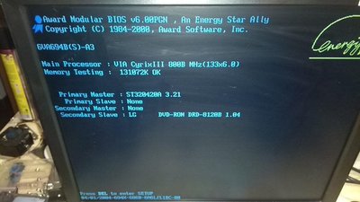

Reply 1 of 1, by Nemo1985
A little update, I tried to patch the bios, but nothing changed.
I really can't understand, the cpu is an 800A while the bios keep saying it's 800B (that according to my google search it doesn't exist).

Bios screen

Cpu picture

Bios voltages
