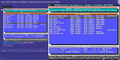

Reply 26 of 36, by RayeR
Here's BIOS module list in AMIBCP. I explored all and none of them is VGA BIOS.

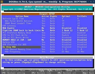

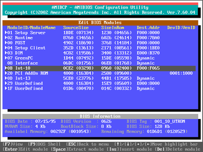

Reply 27 of 36, by analog_programmer
Here're two pictures from my M571-colone's BIOS-dump.
Obviously the VGA BIOS module is not named VGA-something. Use NSSI to save it to file it as I already wrote. Then you can search and compare this part in full motherboard's BIOS.

OK, I can't find menu-item to manage which video adapter to be initialized in this particular PCChips AMI BIOS, but I'm sure in other AMI BIOSes I've seen such an option.

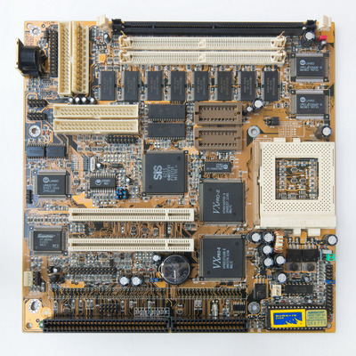

I made some better photo of my M592

Reply 32 of 36, by analog_programmer
Do you see the JP6 "jumper" (bridge) that is soldered to its position? There's no info about it in the manual. If this mobo was mine, I'd try changing its position by soldering a three pin jumper-header on its place.

Reply 33 of 36, by RayeR
Yes, I oversight this. Sure, no problem to solder pin header instead and try what it does 😀

Reply 34 of 36, by RayeR
Hm, flipping the jumper didn't help to run ext. VGA but internal VGA got scrambled screen. When I pulled jumper out I got just blank screen on internal VGA (monitor detected 720x350@70Hz but blank), ext. VGA no signal at all. So the jumper is somehow VGA related but not that I wanted. It had a reason to be hard-soldered.
I also tried add pull-up at pin MD17, 18. Either one disabled int. VGA but ext. VGA still doesn't boot up.
MD17 pull up - POST stops at code 2Ah (sooner), ext. PCI VGA no signal, ISA VGA out of range (94Hz)
MD18 pull up - POST stops at code 80h (later), ext. PCI VGA no signal, ISA VGA no signal
both pull ups - POST stops at code 80h (later), ext. PCI VGA no signal, ISA VGA out of range (97Hz)
