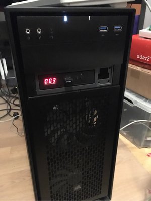

Reply 3 of 8, by root42
I snatched a 3.5 to 5.25 inch drive bay on ebay with a cutout for USB. I removed the USB ports and will dremel away some bits and pieces and then a standard rocker switch will fit in there. This will be my power button. Also it fits my GoTek nicely, which will soon be modded with an OLED display... 😀
I did not connect the Turbo button. Did not have need for it yet. Reset and HDD LED are connected, though.
980.94 KiB
1233 views
Edit: I also bought a few blank ATX IO shields and use a big sink head on a stationary drill to slowly drill a hole for the DIN keyboard socket. Worked like a charm. I can order more and make more, but it won't be cheap. I think they are 8 EUR from mindfactory, and it takes me a bit of time, plus shipping...

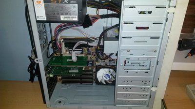

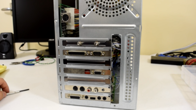

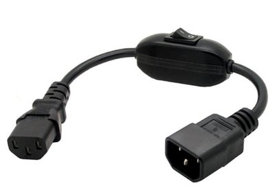

Reply 4 of 8, by Revolter
Yeah, I went the same route of using the ATX power button for a turbo switch (just replace the momentary switch with a self-locking one inside the button and you're done) and turning the PC on and off with the PSU power switch on the rear. There is also this thing if your model doesn't include the switch:
36.41 KiB
1222 views

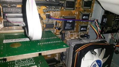

BTW, mine is not a turbo switch per se (since on my 430VX board it is enabled via a hotkey), but rather a FSB+Multiplier combo: 2 wires for shorting the FSB modifier pins (only 1 state is required to choose between 50 and 66, since with no pins shorted the board just defaults to 66 Mhz) and 3 wires toggle between 1.5 and 2 multiplier on the pin grid behind the CPU heatsink. It does make a difference in some games.
