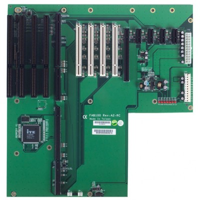

Reply 62 of 130, by j^aws
cyclone3d wrote:
j^aws wrote:
cyclone3d wrote:
True.. but we are talking about DOS/Win98... so PCI-E is a moot point. You won't have any drivers for any PCI-E video cards in Win9x.
I'm also not sure exactly why we would need an uber fast CPU for DOS/Win9x.. but that doesn't stop me from wishing I had a faster PICMG or PIAGP setup than I already have. Just for fun!
The PICMG CPU boards I posted links to both use the ITE8888 bridge chip so they should have full ISA compatibility.
Firstly, PICMG 1.3 boards with ISA slots exist. And some PCI-E GPUs do have Win98 drivers. However, in
such a setup, you'd use a fast PCI GPU for Win98 duties and the PCI-E GPU for WinXP duties. You can also supplement DOS duties with an ISA video card, too.
Link to said PICMG 1.3 backplane with ISA slot(s)? I would guess that the backplane would have to host the PCI to ISA bridge as well?
40.85 KiB
835 views
Axiomtek FAB100. My interest in one is building a DAW, rather than an all encompassing PC.
Reply 63 of 130, by ruthan
If i found right thing its not expensive as i tough..
https://eu.mouser.com/ProductDetail/Axi ... m%2fjuWg==
130 Euro.. its fine, its ATX too, only case would be hassle.. or at least i dont now nothing about good cases for such stuff. I dont have problem with big cases, i actually like them, more room to operace and add some stuff inside pc, i would only prefer some tower than some classic rack case orientation..
I dont mind, if someone find something with and much more PCI-E long slots (only 1 or 2 ISA / and 2 PCI slots are enough for me), it would be even better.
Reply 64 of 130, by cyclone3d
ruthan wrote:
If i found right thing its not expensive as i tough.. https://eu.mouser.com/ProductDetail/Axiomtek/FAB100?qs=XynAqUfUlD2G80klm%2 […]
Awesome. And it has the ITE8888 bridge. I will have to get one of those at some point as I already have a couple PICMG 1.3 LGA775 CPU boards that I got for like $40 total a while back. Also have an LGA1155 PCIMG 1.3 board. Forget how much I paid for it, but is was really cheap.
As for more PCI-E x16 slots.. not going to happen. The most you are going to get is 2x slots that run at x8 because the chipsets used don't have enough PCI-e lanes to handle more than that.
And as far as I can tell, that backplane is the only PICMG 1.3 backplane available that has ISA slots. Not coming up with any others when searching.

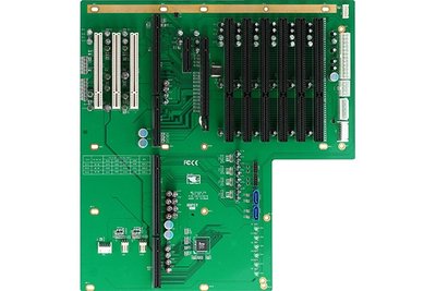

Reply 65 of 130, by j^aws
95.08 KiB
820 views
Here's another PICMG 1.3 with ISA: Aaeon BP-214SH-P3E2I6
Reply 66 of 130, by cyclone3d
j^aws wrote:
